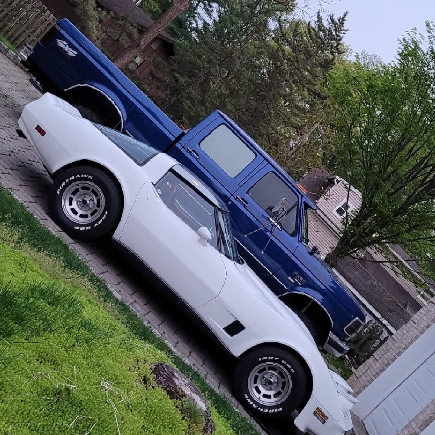

I had 275/60r15 in the stock wheels of a 1980 and loved it love the look but handling sucks because thats a wide tire on 8in wide wheel. Now I have 275/40r18 and want 275/45r18 to mach the look I had with bigger wheels. My e brake was disconnected but as fare as I know that was it
