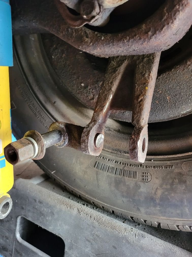

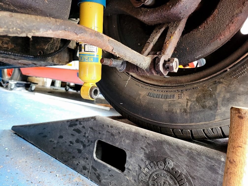

Adding to an old and vexing thread and body of knowledge. I don't doubt that many have had a relatively easy time with this repair, especially from very dry areas, but it also amazes me that some folks insist their way will work for others. I thought I might be OK when the castle nuts came off pretty well with a electric impact gun. Not so much. I can flat out say, there was no way it was getting knocked, or hammered through. Maybe an Oxy torch, but MAP gas, every rust penetrant known, gear puling, gear pushing and hammering yielded exactly nothing.

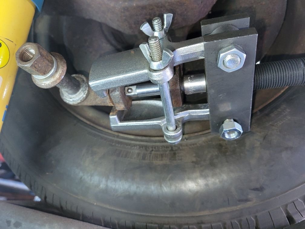

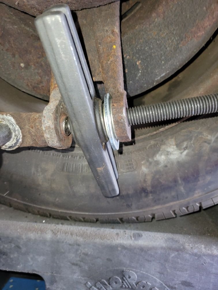

I finally just cut through the mount on 2 sides and pushed the remnants through with the tie rod puller.
I then tried just the tie rod puller on the remaining side and with the load it placed on the mount, well in excess of a 5 pound hammer smack, nothing moved. I then cut it out in 2 pieces and was done. A really PITA job made more so on ramps and not in the air!
