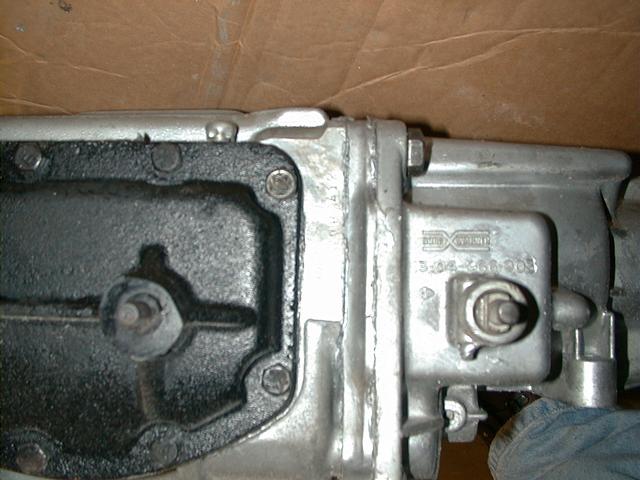

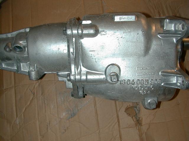

Good news! I got a transmission, and I paid a total of $0.00 for it. w00t. The only problem is I don't know anything about it. From what I have been able to read and whatnot it is a Borg Super T-10.
http://www.dellanave.com/corvette/la...10_640x480.JPG http://www.dellanave.com/corvette/la...11_640x480.JPG
All the numbers I can find on it are as follows:
13-04-066-903
2CL544561
WH412
MLTS819
FpC4
How can I find out what ratios are in this trans? Will my stock shifter (that was found in the back seat of the car) bolt right up to this tranny? (I assume it will, but as long as you guys are around, I don't rely on assumptions ;)

I am pretty sure your stock shifter will bolt up to a Super T-10 though
They are identical to Muncies (with little differences by year and wide/close ratio).
AC

I don't know anything about the trans, but the pics are working now. ttt. :D

It does look like a Super T-10 NOW count the rings on the mainshaft and report back.You WILL have to remove the side cover and look at specific things to see if you got a "good deal" or a "boat anchor" ..redvetracr

I called my uncle to have him look at the trans (which is why I am not 100% sure) and he said there are "2 rings on the splines on the input shaft" Does this make sense? If so, what do the 2 rings mean?

It`s a close ratio 2.43 1.61 1.23 1.0. In my opinion a "close ratio" is the BEST one to have.I use a "modified" version in my vintage racer ...redvetracr

redvetracr - The trans has been rebuilt as you can probably tell from the pics, so I'm not totally sure if what's inside matches the case numbers etc. What exactly told you what ratio it was? Couldn't be only the rings? I can take the cover off this weekend and look in more detail and count teeth etc. I will also take more pics, seems to me if it's been rebuilt it should be pretty good. I think I'm going to hock the 2 stock shifters I have now on eBay and see if I can come close enough to buy myself a Hurst

You got a rebuilt close ratio Super T-10 for free? (even if the other party owed you big time) That's awesome.
In any case, that's the exact same tranny (2.43 first gear) that I'm running in my 68 camaro. Unless you enjoy changing clutches every 3-4 months make sure you don't run any gears lower than a 3.55, 3.36 may be cutting it close. I ran that tranny with a 2.56 rear gear set up when I first installed it.
It was like trying to take off out of the pits with an indy car. I was changing clutches ALL the time, good thing I had a lifetime clutch from checker. I now have a Ford 9" with 3.73 gears and a Centerforce clutch and wow that made a difference.
As far as the shifter is concerned I *think* it will bolt right up. I converted my camaro from an automatic, so I just ended up using a hurst competition plus shifter. The Muncie and the BW supposedly share the same dimensions, but have a different mainshaft design. I know for a fact you can use the same synchros and sliders in the Super T-10.
When I was in AZ I saw an M-20 and a Super T-10 side by side disassembled, the only real difference I could tell was that the gears were cut at different angles and had a slightly different shape, the one's on the ST-10 were "sharper" for lack of a better word. the splines for the reverse gear on the mainshaft are helical on the muncie whereas on the ST-10 they're straight. The Case design for the Super T-10 is a little stronger than the Muncies, but other than that they should drop right in.
