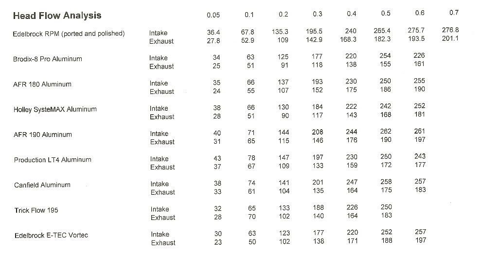

Would appreciate some help from everyone on understanding the following. I had my Edelbrock RPM 64cc heads ported and polished when they were first installed but I lost the flow data... Just found it but am not familiar with what is Good, Better or Best... or not so good for that matter.
Could I get some input on these numbers and your opinions of the results.

Those look good! For reference you can look at the flow data for the AFR 195 and 210

They did a good job. They out-flow my Edelbrock Victor Jr. heads (unported)

Here ya go.

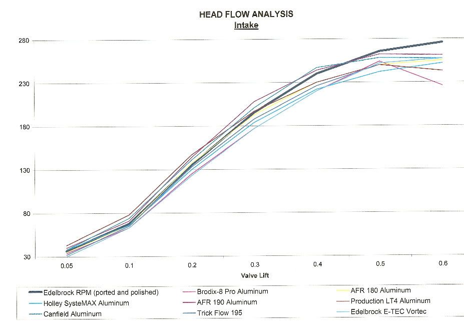

Thanks again everyone... I took all of the data and built a chart then graphs of the INTAKE and EXHAUST data by head. For reference, my data is the bold line on each chart. Am happy with the overall performance but have a lot to learn about this data.

Do you have a measurement on the intake port cc after porting?
