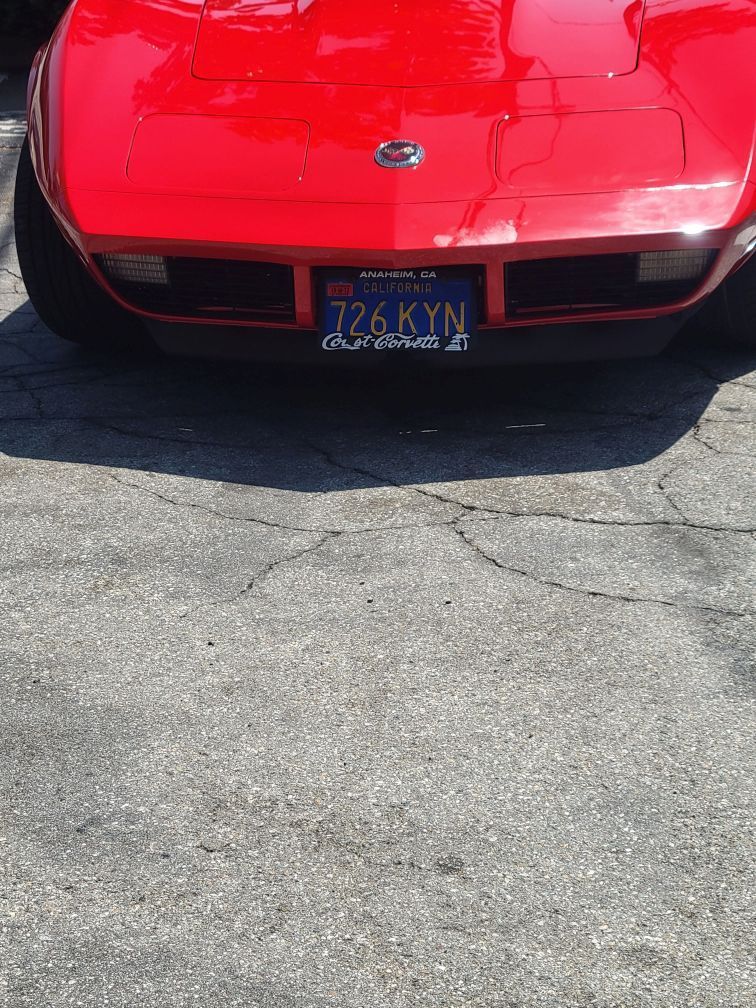

73 Coupe with AC that runs hot at speed in CA during 100+ degree Summer weather. 3 row aluminum radiator, dual fans. Bought it that way, wish it had the original radiator, fan and shroud which is a better system. Out here you need a front plate. Took a look at the license mounting frame that blocked the entire opening and did a Bubba alteration.

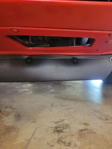

Removed the license plate frame holder. Screwed a piece of strip steel to the upper bracket mounts. Attached the top of the license plate to the steel strip. Now the plate leans back, gained a good 11' of air flow with the plate acting as a mini air dam. Totally visible from the front to avoid the no plate ticket. Last pic is the air dam extension made from $10.00 of supplies from Home Depot for those who noticed it in the license plate pics.

Looks original from front and hopefully legal
$10 air dam extension

i was going to suggest dropping the plate down a couple inches and tilt the bottom forward making it into an additional air dam. great minds... 75-up would take some cutting and removal of stuff begind the bumper. and then get a vanity plate that says DAM and see if anybody gets it... Newroy, did the plate-splitter help with engine temps?

Yes, it does run cooler. Surprised me how much effect this had. Held fast at 180 or so all day yesterday
