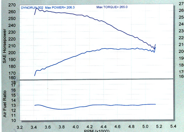

I just got back from the dyno. What is a good % drivetrain loss number to use on a TH350 auto? 18%?
I am pretty happy with these results. My motor was a stock L-48 originally. It was rated at 185 hp flywheel.

Not bad -- looks like you leaned out a little in the mid range --- I am sure Lars can help you on that !!

Actually, the tuner said it was way too rich. You could smell the gas, but no cats.

Sounds REALLY good on the dyno.
Sorry - I read the chart wrong -- .
If I remember correctly, probably not, your want to stay between 13.1 and 14.1 on the air/fuel ratio.
Also know that leaner runs hotter. So if you have any cooling problems now -- get those fixed first.

So... what are we looking at? 4400 RPM is the best ratio for HP & torque? :confused: :confused: :confused:

On my engine, that feels about right. But, as you can see, seat of the pants (torque) seems to keep increasing through that range up to 5200 (as per the equation).

Rhys, I just had mine on the dyno today too. The rule of thumb for loss though the drivetrain is about 15% for manual and 20% for auto. This is just a rough estimate but should be close.

That is what I thought. I think we were using 15% manual and 18% auto on our C5's. I was not sure if there was a difference on a C3 driveline.
That puts me around 257-263 engine. Not bad for the small mods.

Yeah, those are pretty good numbers. Are your heads stock?

Okay, dyno experts.
So what does it say when torque drops off continually? Is Rhys not getting enough flow
into the heads to sustain the torque?

:D Looks like the mods paided off.

Rhys, your dyno results are virtually identical to mine, both curve and the HP/TQ numbers (I'm 2 higher on torque). What mods do you have?

Started with stock L48 motor. Replaced the heads with some "993" chevy heads, Comp Cam 268H, roller rockers, edelbrock performer intake and dual exhaust (no cats)
