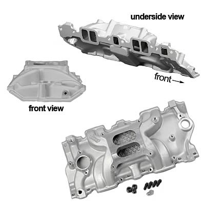

http://store.summitracing.com/partde...5&autoview=sku
This one states that it is both spread and square bore. How does that work? Also, this looks like it is shorter than the EPS.
Also, the EPS and the Summit brand street/stage 1 intake look the same other than the texture inside.
Summit
EPS
I guess I am unclear as to what the best option is. My understanding is that the dual plan manifolds will be smoother across the largest RPM band, and I would assume the smoother and less restrictive the manifold is, the better off I will be.
