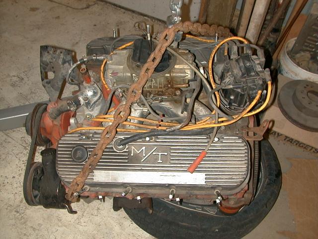

All went well hauling the engine in my S10 on top of a tire. Although the poor S10 was crippled (pos). I'm pretty happy with it from the looks of the engine, of course that doesn't always paint the whole picture. Basically I got a running (well) 454 with a bad starter for $1200. Not bad at ALL.

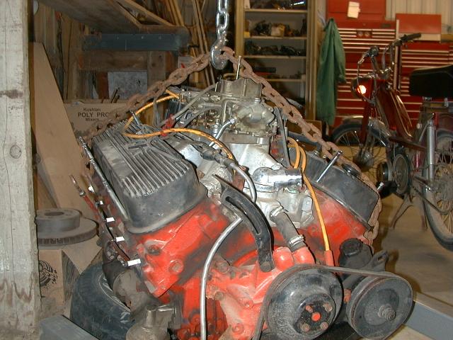

Maybe its just me....but the chains on the valve covers must hurt them pretty bad.....and the engine resting on the oil pan? Maybe I'm being overcautious..but anyway...I don't see any reason why you couldn't paint the block fully assembled. Sure it won't do a PERFECT job but if you take your time you could get very close. And I truly agree with you that a black block looks way better than an orange one....at least they're not blue like fords.

The chains aren't actually touching the valve covers believe it or not. And yes the engine rested on the oil pan on the tire for about 2 minutes until it got on the engine stand. It travelled 100 miles on the tire, I dont think it would destroy it to sit there for a week even
