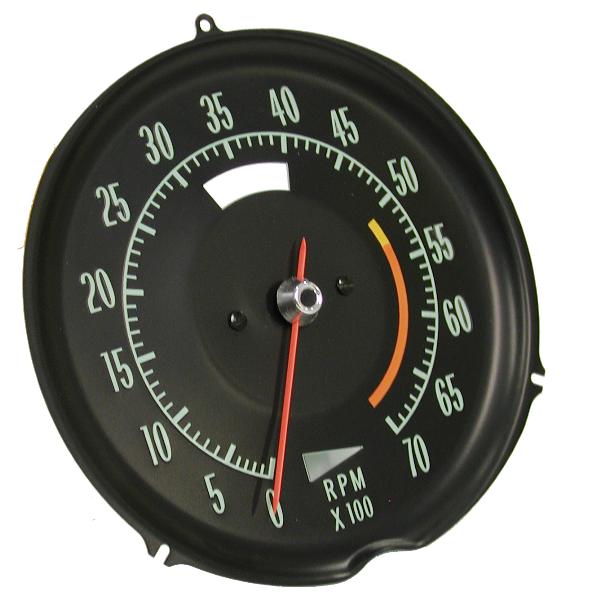

QUOTE=jackson]AFAIK ... '71 & earlier have greenish cast to numbers & tickmarks ... '72 up are white (like '75-'77 elec).[/QUOTE]
[IMG][/IMG]
The 75 to 77 have a different font style to the numbers too.. Swap the faceplate....
