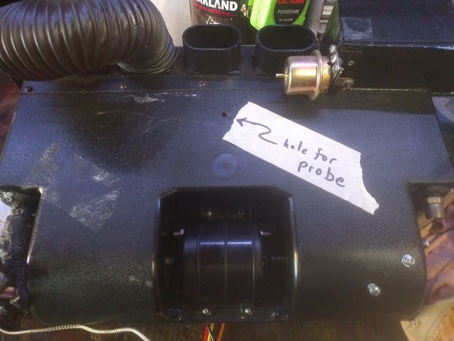

Guys,
Installing Hot Rod Airs kit in my 71. There is a 'thermostat' wire coming off the temp selector, it comes coils up when shipped. Does this thing need to get inserted into the evaporator, routed somewhere, or just left curled up?

Default It goes into the top of the unit...
Just about centered between the air outlets you'll find a little-bitty hole and you insert it there.

Old Mar 29, 2020 | 06:10 PM
carriljc's Avatar
carriljc
Joined: Jan 2001
Posts: 6,728
Likes: 1,379
Since I am updating another post, I figured I'd update this one also...in case someone goes looking:
To Hot Rod Air Temp Sensor?
