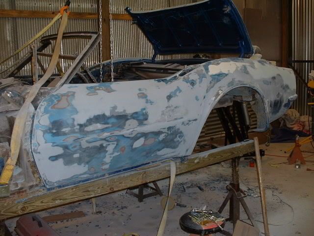

I did mine the cheap way, actually free. I had the jack stands and 4x4's in the shop already. so I put them to use. it worked really well for cleaning and detailing the underneath of the body. I bet you will not put that body back on a dirty frame without cleaning and painting it at least. good luck

I have done it a few times, don,t try to lift it by hand, as is bulky and awkward and someone will get hurt.
I built a frame over the car in my shed, lifted it with four chain lifters slowly, by myself, and left it there while I did the frame up
You must support the front clip as it moves around otherwise and could loosen or get damaged.
Sorry dont know how to post photos, but the timber only cost a few bucks.
