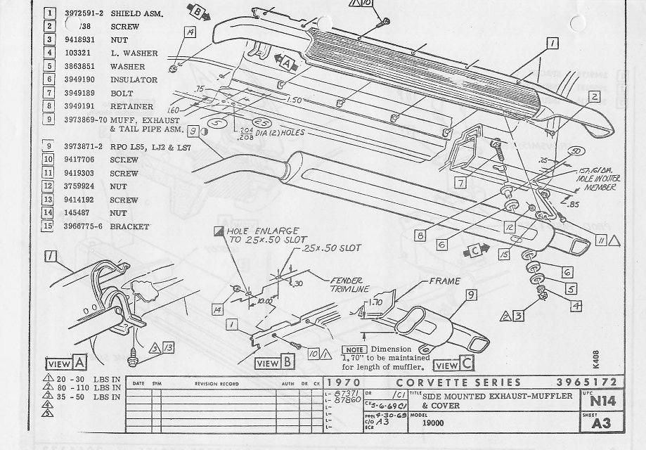

What do I need to hang factory side exhaust on my '81 besides these:
http://www.ecklers.com/product.asp?p...&dept%5Fid=158
I understand the use and location of the bushings, sleeves, washers and nuts... but what is the little hardware for? I don't have an AIM for '69. Also does anyone have an AIM page that shows the bits and pieces (and places) they might PM or email me?

The smaller screws are for the rear brackets that go from the covers to the frame. A bracket goes on each side. Here is the page from the AIM you are looking for.

Many thanks!!! That's exactly what I was looking for...
