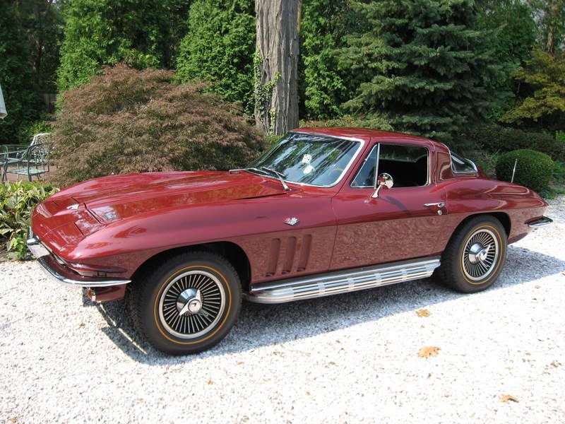

We put under car exhaust on this 66 and left the side pipe covers on because we like the look. You could do that also. I don't see the benefit of two systems. A lot of pipes under a car w/little room. Why not put in a 2.5 or 3 inch performance exhaust system w/flowmaster mufflers. If you want no mufflers for racing put in the cut-outs. .02
