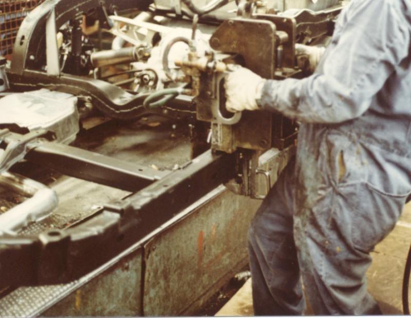

Same for 69 or 71 and most C3 corvettes. Here is photo of location and the machine that stamped it at the other location.
