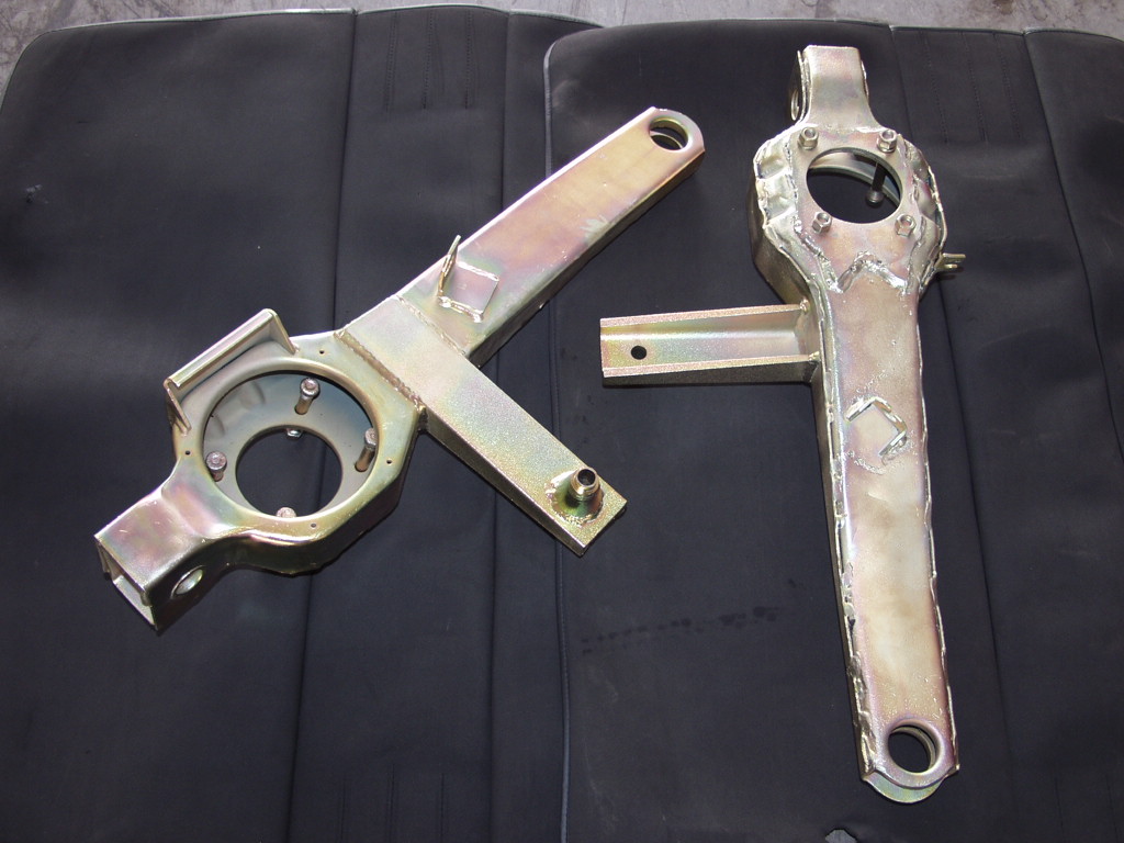

here ya go

What gen. Vette is that setup out of T.T And how much??

C3, it's a stock setup w/ just simple brackets welded to the trailing arms.
The diff is an 80-82 unit drilled and tapped for a custom toe contol center mount plate and 2 struts like the C4 (and they are for toe control, not a 6 link. I haven't seen the rest but I think they have a floating front trailing arm bushing so the rods control toe, not the arm itself...but that's a whole other story)

So just fab the shock mounts and some coilovers and thats it???
TT,
Ya got me confused here. The rear diff sure looks like a C4 D36 in a C3 frame, rather than a modified aluminum C3 differential. Regardless, it's still a nice looking piece of workmanship.

you're right, it's a D36... they had another pic that has a converted c3 D44...I didn't look at the pic too well and assumed this was the converted older style. I would however never use the D36, it's a weak POS. Even weaker than the C3 one it seems.
Sly, yes you need a u channel and fabricate the 2 mounts, just taper them down to the bottom and notch the other side so you can weld them to the corner of the trailing arm. If you need a 3d model to explain it a bit better let me know, I can whip it up in a jiffy.

This is one of my rear coilovers. Use only 5 inch travel shocks if you are going in this position. YOu need to keep the total length of the shock as short as possible to keep the lower mount at a reasonable height. A 5 inch travel shock gives 7 inches at the wheel.
The top mount in in the right location.
I welded my lower mount to the side of the trailing arm
