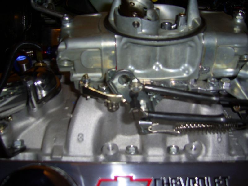

I just installed a new ZZ4 with a 650 Speed Demon. I can take a picture of my cruise connection if it is of any help. Let me know.
That would be very helpful!!!! Thank you!

I just drilled a hole below the throttle linkage and bolted my original Quadjet cruise stud in. I am using part of the original bracket from the Quadjet carb as well so that I could use my original accelerator and cruise control cables.
Thank you for the pics! They helped!
