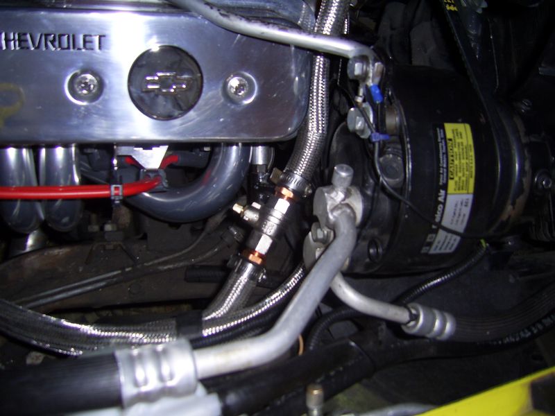

I installed my ball valve right back of the A/C compressor. I carry the handle in my storage compartment so that I can open it up if I wish. I still have the original valve there as well.

I just went to the plumbing dept of a local hardware store and picked up the stainless valve and the two fittings. These valves are readily available.

Here's a picture of the PEX valve I am using. I installed it in place of the stock vacuum valve, but you could put it anywhere you want in the heater core loop. As you can see the ends are already barbed, you you dont need to buy additional fittings or nipples, just clamp it on.
