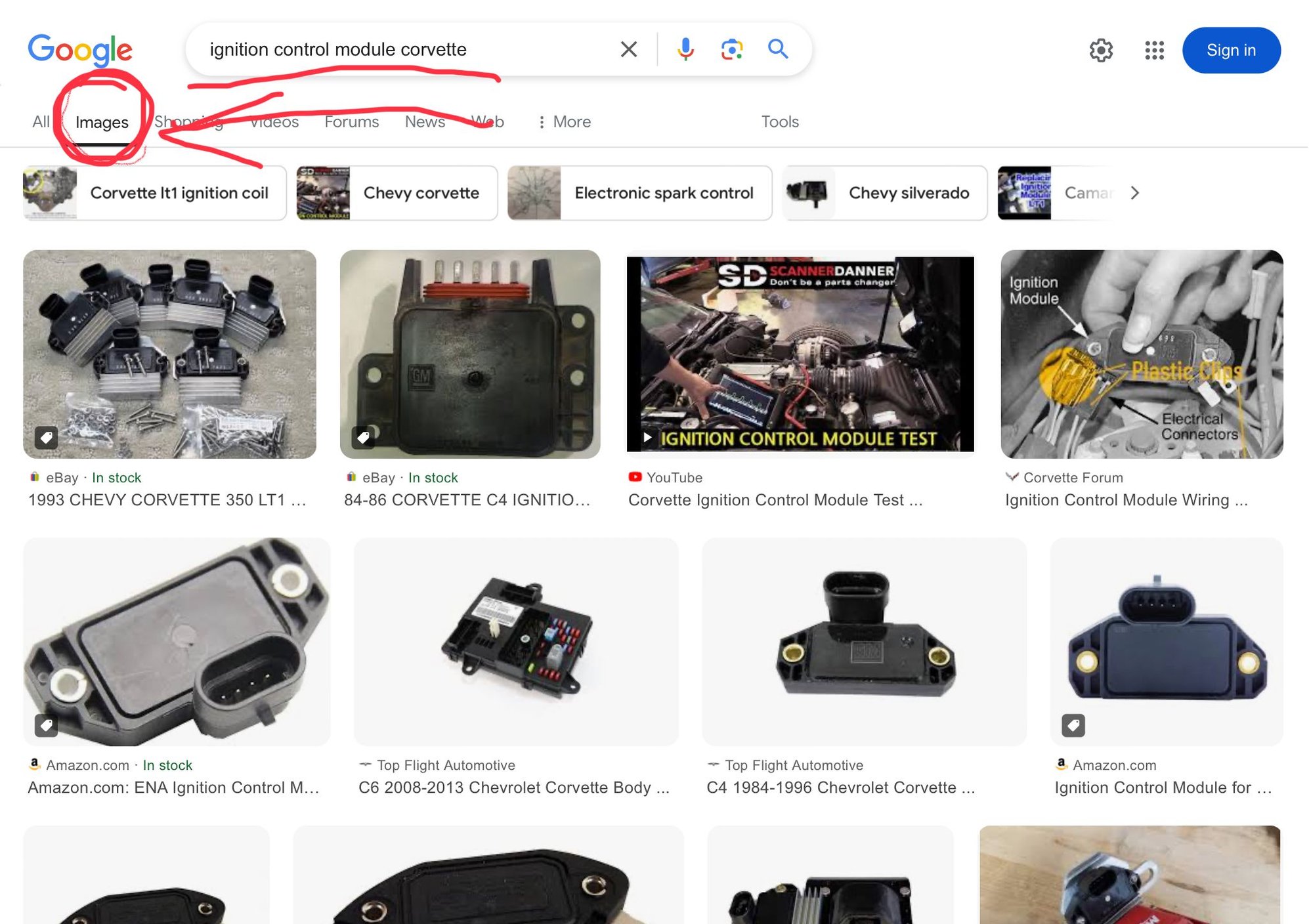

I think that's what's happening with mine. Where did you locate the ignition control module?
of all the videos I'm finding, none show whereto find this part.

Depends on the year and type of ignition. Google search “Ignition module (insert year) Corvette” and click on “images” to see available pics for guidance, or click on those pics to see what they say.
