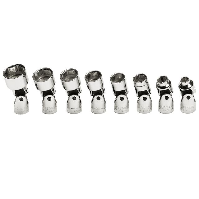

I bought a set of craftsman 1/4" universial sockets. Using that, a small extension and a 1/4 to 3/8 adaptor gets in there well. They are 45 bucks at sears, I found them on ebay for less.
i use the same thing, makes a hard job easier, if you can invest in many diffrent sizes as the do come in handy.

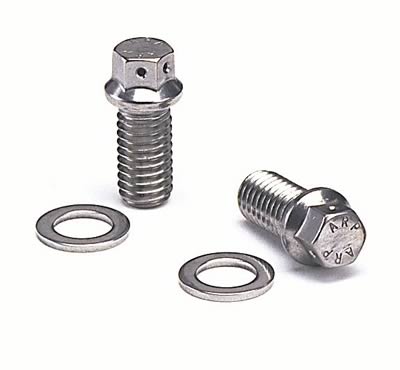

I always use reduced-head bolts for the headers. It is just so much easier to work with them.
I usually get ARP stainless.
