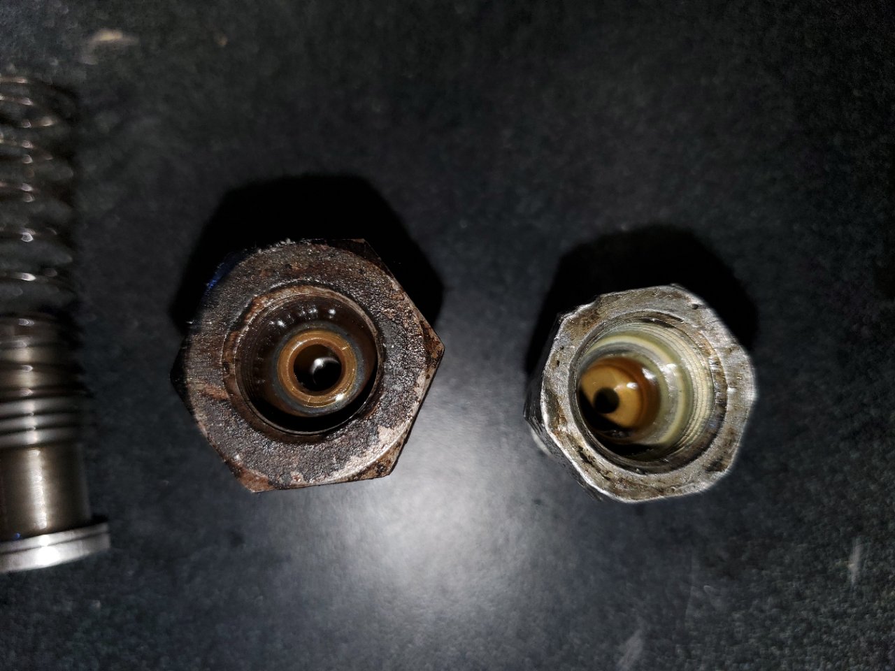

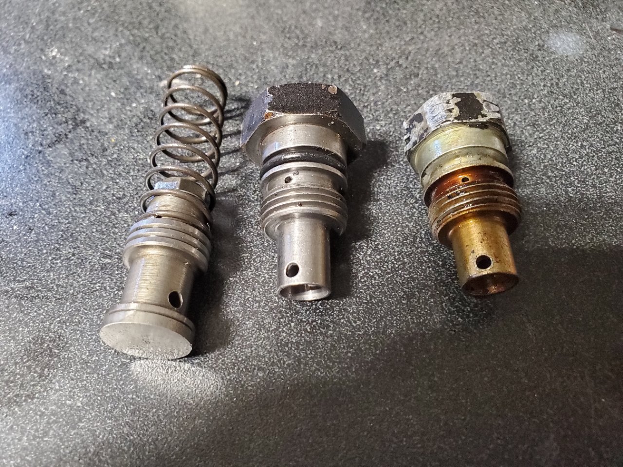

Old Mar 10, 2019 | 11:06 PM
jetplt67's Avatar
jetplt67
Cruising
Posts: 11
From: Mesa, AZ
I just wanted to add a couple of pictures to this thread. I am in the process of putting a 91 L98 in a 79 C3. I took advice from this thread and a few more. I pulled the power steering line-out valving from the 79 and put it in the 91 pump, so I could use the C3's factory power steering. It fit perfectly. Interestingly enough the C4 power steering pump didn't have any valving inside. (I bought the engine from a guy who had already swapped it into a kit car so he may have gutted it to make it work for his application).
The silver valve and fitting on the left are from the 79 and the brass fitting is from the 91. No valve from the 91. Nearly identical from the outside, threads are the same, pressure line fitting is the same threads too. The outside nut for the fittings are 1 1/16 inches and 21 MM respectively.
If you look carefully you will see that the port size in the left one (79) is a little bigger than the other (91)
The fitting on the left has an orifice (for lack of better word) inside it, that forms the flare lip for the pressure line. The other doesn't have it.
I hope these pics help someone, it would have been nice for me to have had a few months ago.
* disclaimer: I haven't started the engine yet, so this is all theory at this point, however I don't anticipate any issues as I have read of many others doing the same thing with good results.
