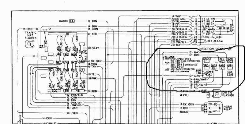

Do you happen to have one for the ign plug?

I didn't trace where all the wires go. But possibly this will help.
Don't forget that the standard (non-adjustable) column switches and the T&T column switches work in opposite directions. So the schematic is correct for both switches, you just have to turn the picture 180 degrees for one or the other.
Jim
