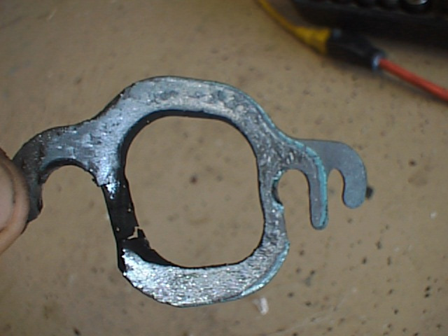

Check your exhaust gaskets. I just spent weeks trying to fix a severe engine knock that I was SURE was some metallic knock in the engine. Never been so sure about anything. Guess what. A $5 exhaust gasket fixed my problem.

Man that sounds exactly like my symptoms. Pull one spark plug wire and start the car. That will tell you alot.

Check this out. If it IS and exhaust gasket, it should be easy to tell.
Look at all the troubleshooting I went through http://forums.corvetteforum.com/zerothread?id=162061

I hear you guys about the exhaust gasket, but a true "knock" doesn't sound like popping or clicking like exhaust would. It sounds like a 500 lb gorilla beating on the side of your block with a 10 lb sledge hammer. It's the most horrible gut-wrenching sound you've ever heard. When lower rotating parts start go go, it's very obvious.

Here is an update after spending the evening troubleshooting the noise.
I replaced the exhaust gaskets with no changes unfortunately. I then unplugged each spark plug wire one at a time and started the engine and the sound remained throughout the test. I then used a piece of hose and tried to isolate the area of the noise and it seemed to be all over the engine.???? The rate of the sound appears to be at the same rate as the valves.
If it is a piston/rod/main problem would the noise be twice the rate of the valves?
The engine has about 5000 miles on a rebuild.
Confused!!
David

Are your exhaust manifolds' connections to the exhaust pipe tight and sealed?
After you check that, I would say, adjust the valves with the engine running next, then move to rockers/lifters.
Can you tell if it is from one side of the engine or not?
One of the suggestions I had (because your knock goes away at higher rpm) is that you have a bad lifter that is collapsed and when you raise the rpm, it finally pumps up. It was suggested to me to try a very heavy oil.
Note: I am no engine expert, but I went through this whole exercize a couple weeks ago with Tom454 and Lars' (and a lot of other's) help
