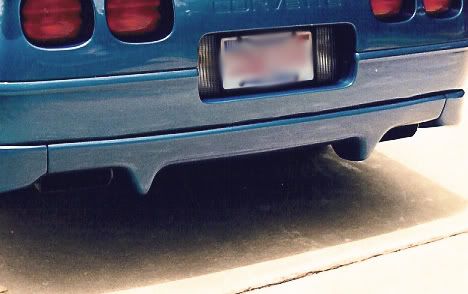

No spare, currently, but I'd like to come up with something between this...
and this...
Originally Posted by 84rzv500r
I was thinking about a sharks mouth on lower front like on that Curtis P-40 Warhawk in your avitar
Can you just imagine looking over your shoulder and seeing that coming at you, guns blazing!?! I always wanted to paint that on the nose of a formula car, but another guy I was racing beat me to it and I didn't want to copy. Done right, it should look right at home on a C3. Can I call dibs?

Kinda like this?
I dig the Thunder racing corvette. That is a pretty cool looking car.
