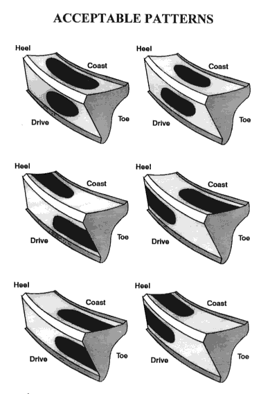

In case you don't have this, you may find it handy...
...or Gary may have a better reference.
