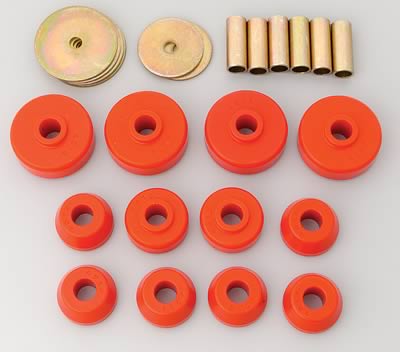

Is this the kit I would need to replace the body bushings? Also how hard are they to replace, please don't tell me the body has to be removed from the frame.

That kit will do the job. The body does not have to be removed but it will have to be lifted a bit, one side at a time. Remove the body mount bolts on one side and loosen them on the other side and use a floor jack with a plywood pad to lift the body a couple inches, just enough to get the old mounts out and slip the new ones in. Be sure and keep the shims together. The #1 and #4 mounts are pretty easy to get to. #2 and #3 are a bit of a challenge if you got big mitts like mine. Take the oportunity to clean and paint the mount brackets and use silicone grease on the bolt threads

Thanks for the input SIXFOOTER, when you say "That kit will do the job" does that mean there is a better set out there on the market?
