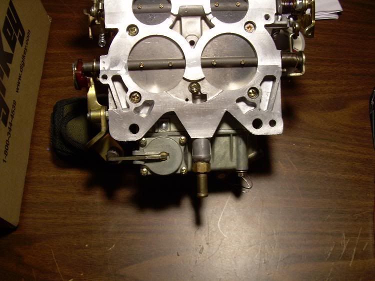

This is a picture of the stock carb, from the front, you can see the single installed main vac fitting on it from holley. On the back, on the same lower plate there is a round hole in the same location as the front,, inside this hole, about 3/4" into it there should be a screwed in plug. you have to look into the hole to see it.
4165 holley
Interesting tube for the power brake booster is coming off the front,
rear fuel pump must be in the way with that style fuel bowl.

Originally Posted by Little Mouse
4165 holley
The front one is for the charcol canister gulp line. There is a hole in the base plate rear that is pluged with a large taped screwed in plug. You need a new, large flat tip to remove it, it is "in there". (I used a new 12" long square shaft klien, had to dremel the sides of the head to make it fit).. then a 3/8" brass hose fitting with the threads ground off, and some JBs weld and now you got two 3/8" vacume ports instead of just one.

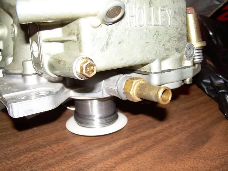

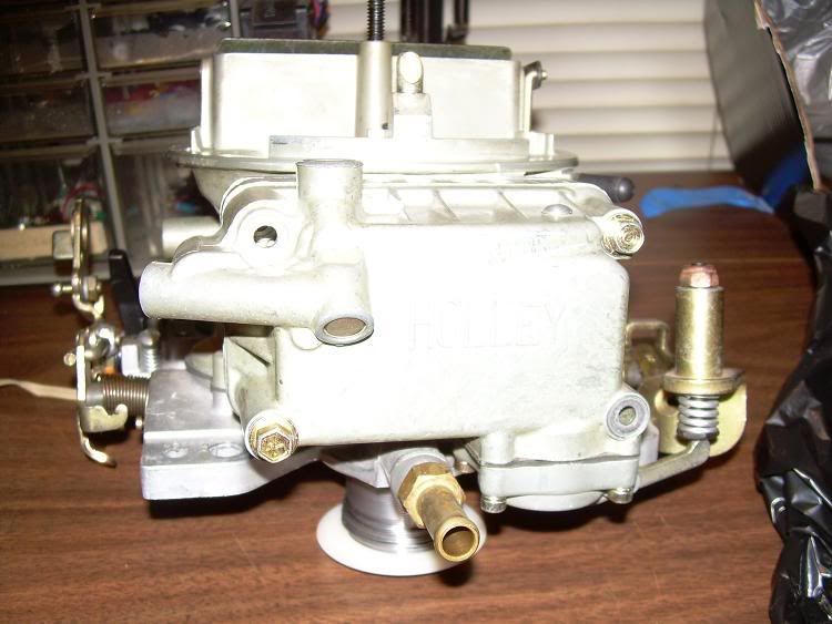

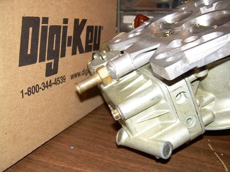

check it out,, this is the rear of the carb:
The plug is locatesd about an inch inside the cast tube the brass fitting is sticking out of. The carb must be removed the remove the plug. It is in there. the hardest flat tip screw I have ever removed, no exageration.
