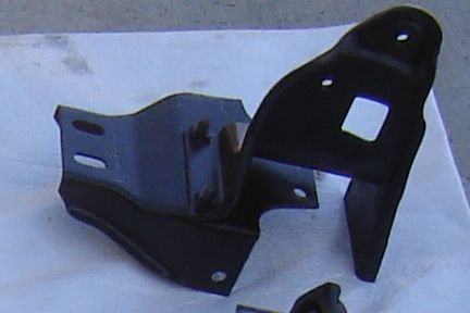

Originally Posted by 69StingraySA
The bracket should resemble this. I don't think this one is exactly correct, but it is similar, and I don't have a photo of mine on the car. And you don't need the vertical bracket that is bolted to it. Just the part that bolts to the crossmember and supports the rear of the trans. If you can find a parts book for an '82 you should be able to look up the correct number. I don't think they are available from the aftermarket. I got mine off eBay a long time ago. And remember all of this requires you to have the correct tailshaft housing for a Corvette.
Also further to the shifter, when GM put the 700R4 in the '82 Corvette they did not develop a new shifter. They used the same one and marked the indicator 2-3-D. There are two ways to modify the shifter to access all four gears. Some guys modify the shifter witth a dremel to add a detent for first gear. There is (or at least was) a kit available from Shiftworks to modify the factory shifter for the 700. That is what I did. It works great, although IIRC the kit did not include a new indicator as I remember having to have one made. But it has been a long time and the details are fuzzy.

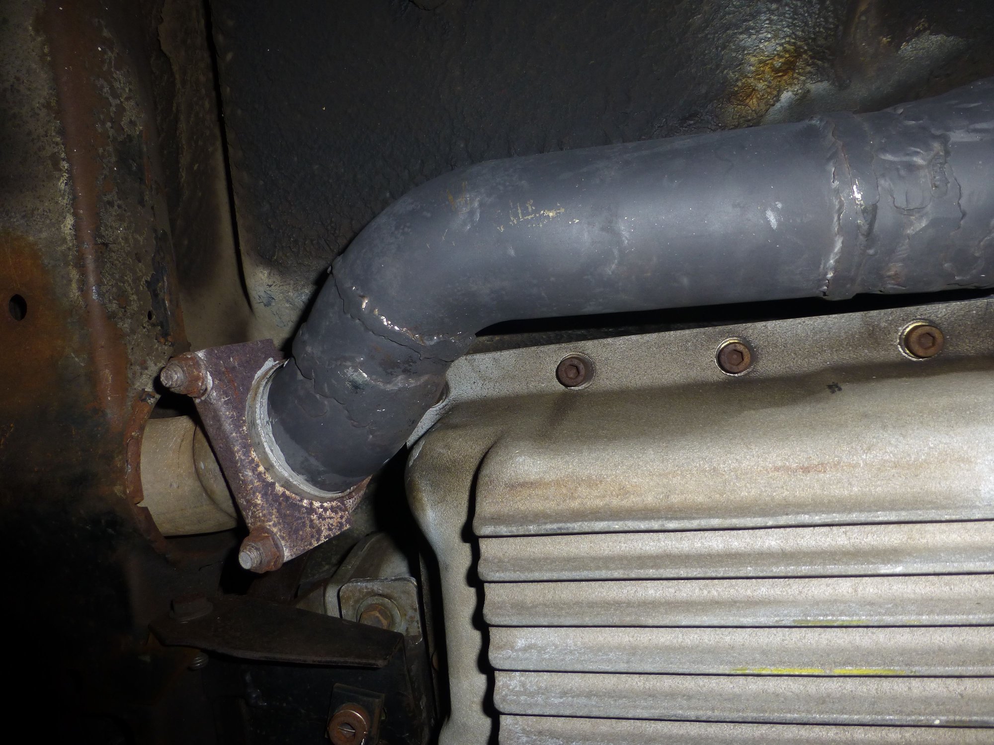

I installed a 700R4 trans in my 78 C3 about 10 years ago. I used the stock C3 trans crossmember, but had a helluva time getting the exhaust to clear the trans pan, especially on the passengers' side, took a whole lot of pie-slicing of mandrel bends to get that sharp bend right at the crossmember to get around that corner of the trans pan. Driver's side is not as tortured. But it's do-able. Like I said, it's been 10 yrs since, many miles later, no problems.
I did have to skootch the parking brake pulley mount over a little bit to clear the trans tail-shaft housing (from a Caprice), cut and re-attach. Trans mount was fabbed up from some angle-iron and flat-strap steel.

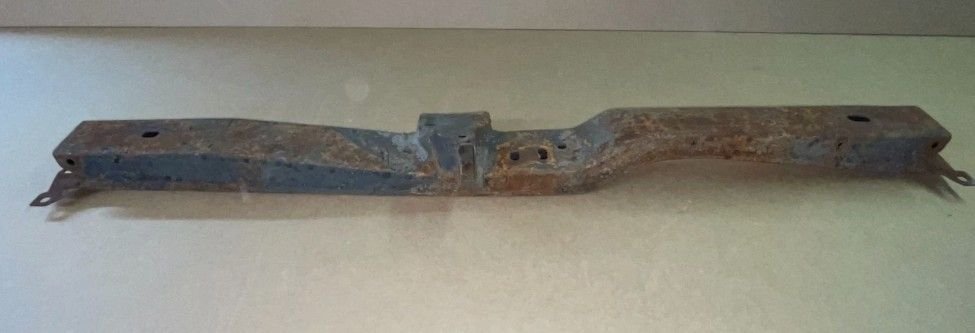

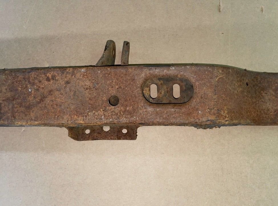

Look here. This is allegedly a 1982 crossmember. All good and well but I'd buy an aftermarket one instead of a stock unit. I snipped some pics below the link so there's something to view when the link dies:
https://www.ebay.com/itm/12745454422....c101506.m1851

rpoL98
That's a bit of work. Good Job.

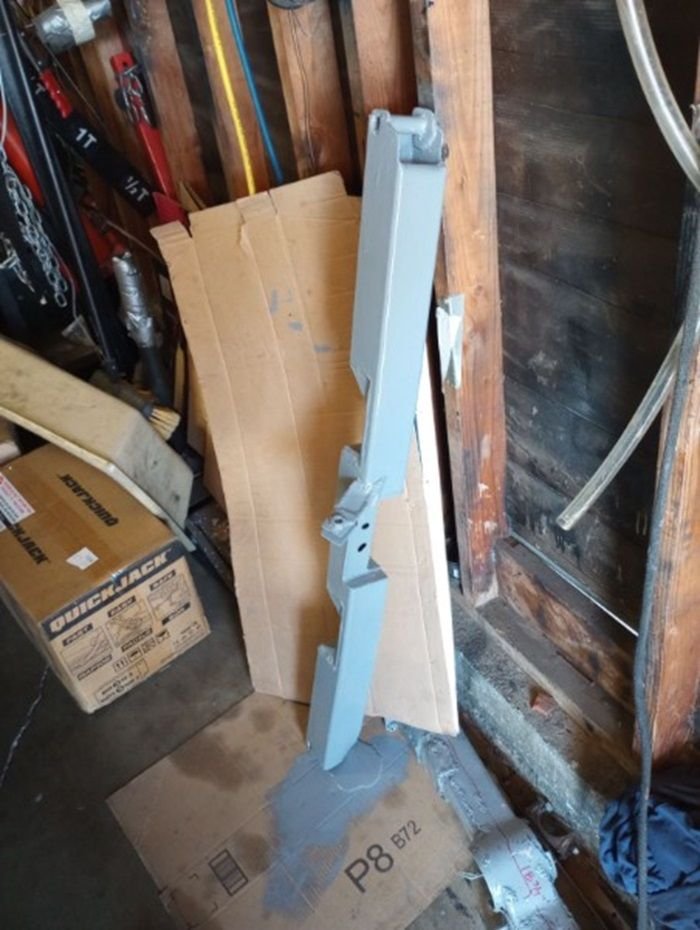

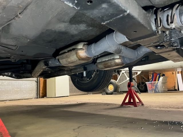

I was having the same issue when installing my 200-4R and so I decided to make my own "exhaust pass under" crossmember" instead of waiting for an aftermarket crossmember to be available for purchase.
I like it all around better than going through the stock crossmember exhaust holes. You can see it here in after painting. Mine was a manual so I had to fabricate the mounts.

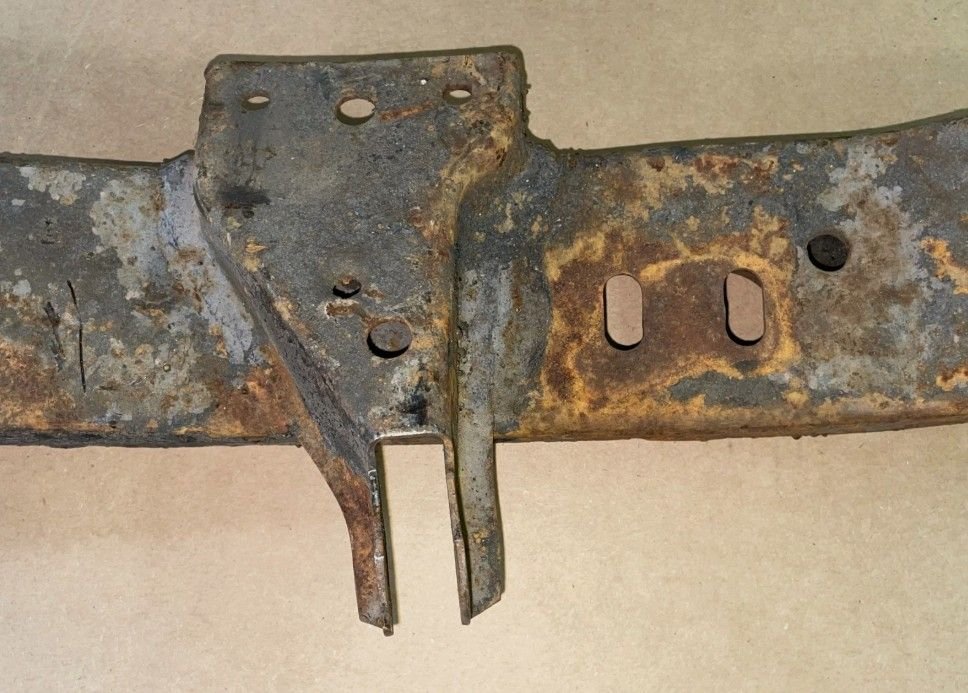

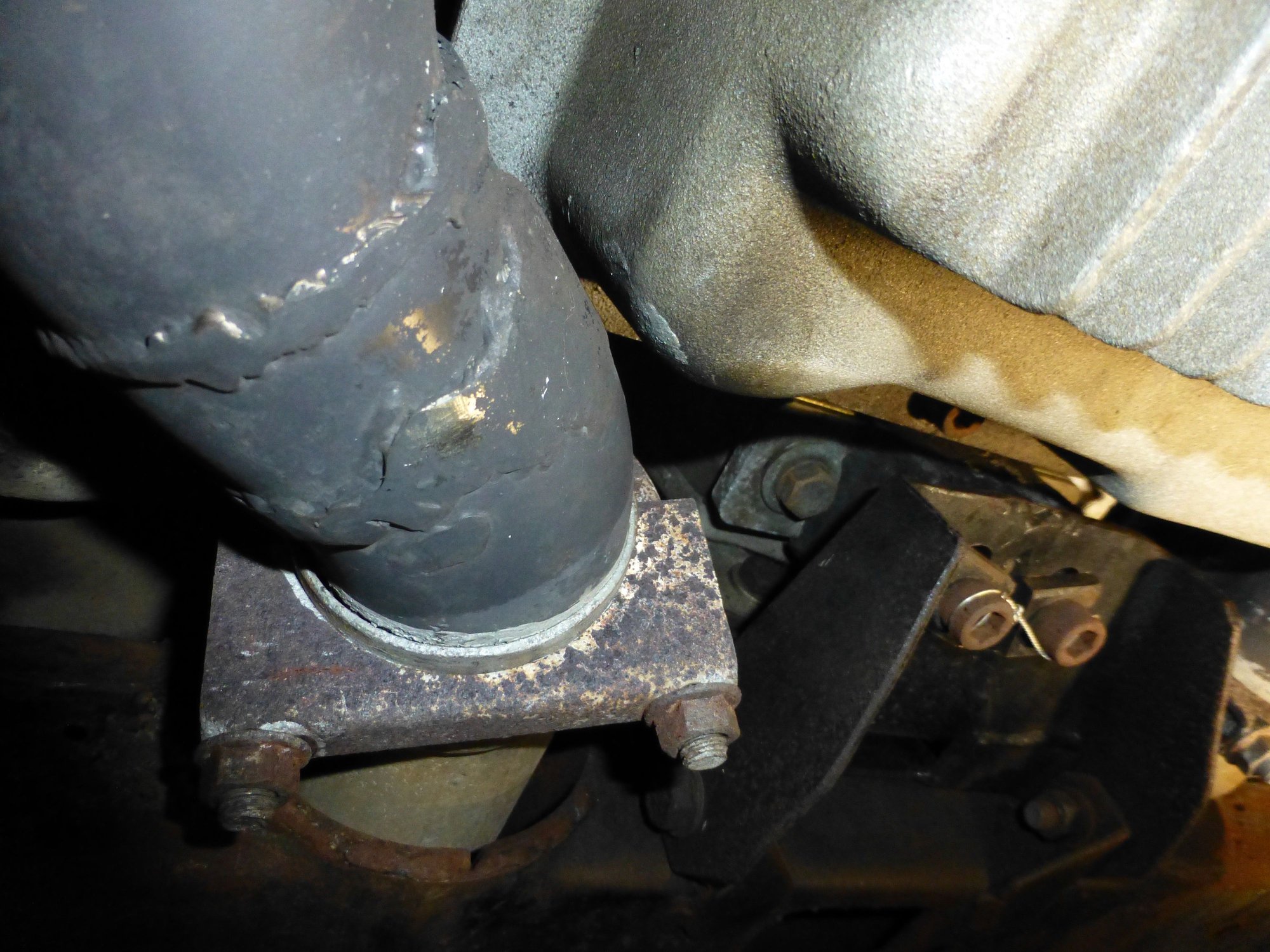

Yes those are both significant issues with the 700R4 installation that I had forgotten about. Moving the parking brake pulley was no big deal as long as you can weld. As for the exhaust, I modified the crossmember to move the hole for the exhaust on the passenger side farther outboard. About 1 1/2" works well if I remember correctly. Just put the crossmember in a bandsaw, cut it in 3 places, and welded everything back together. Much more elegant solution than trying to fit the exhaust around the trans pan.
This is not the greatest photo but it was the best I could find. If you look close you can see where the crossmember was cut and rewelded:
