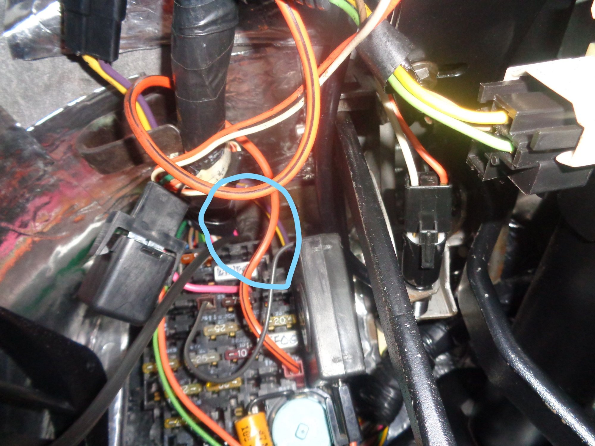

Hello on my 81 a piece of the inner cable was stuck in the flexible outer cable. Removed the old outer cable and found another from a bike for a replacement. Also have a new inner cable with hood release handle. Problem is I cant find where the cable goes through the firewall from under the dash and a wire wont go through from under the hood. I took this pic near the fuse box there is a silver fastener for reference.. I am getting to old to work under the dash.

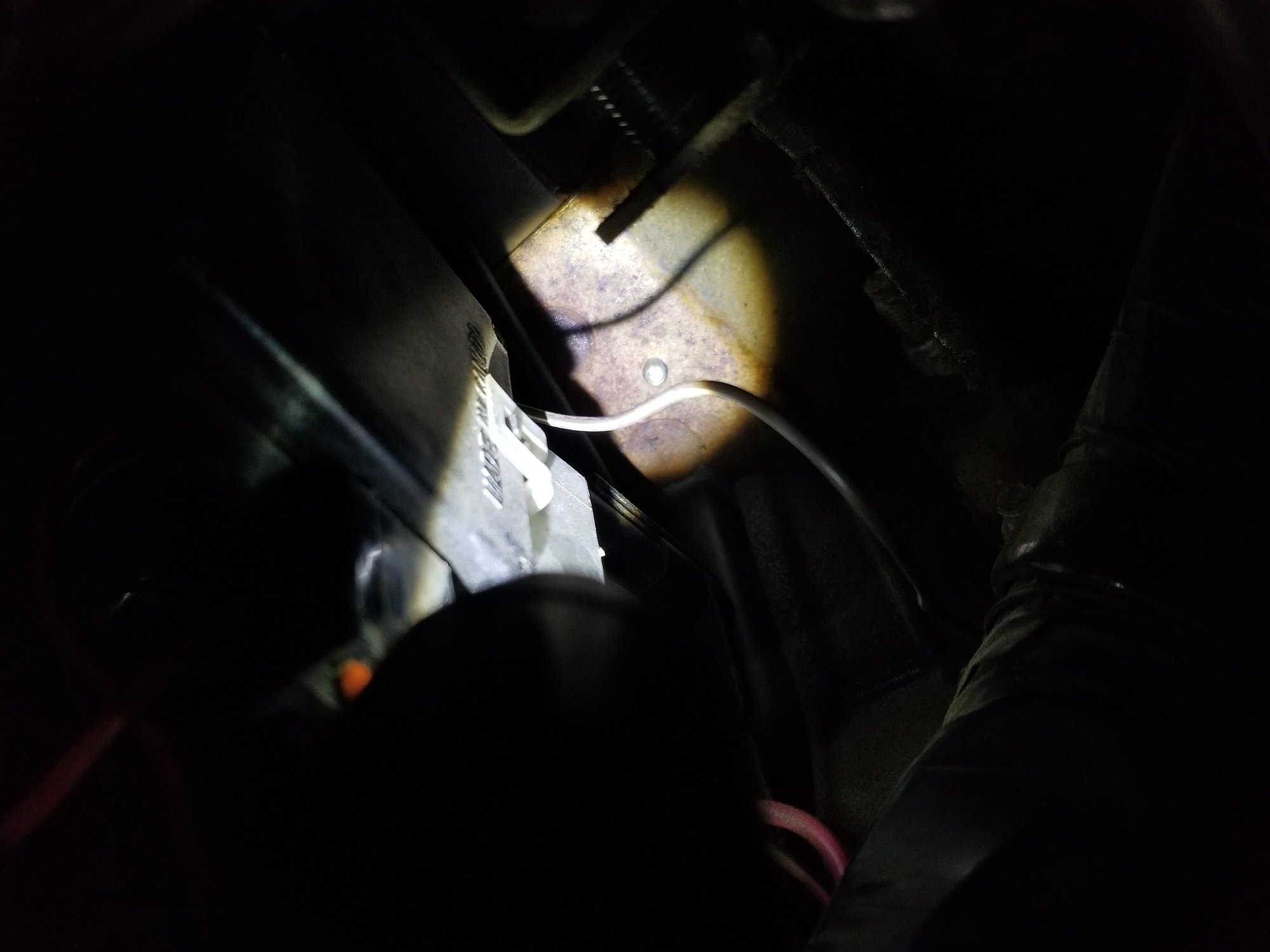

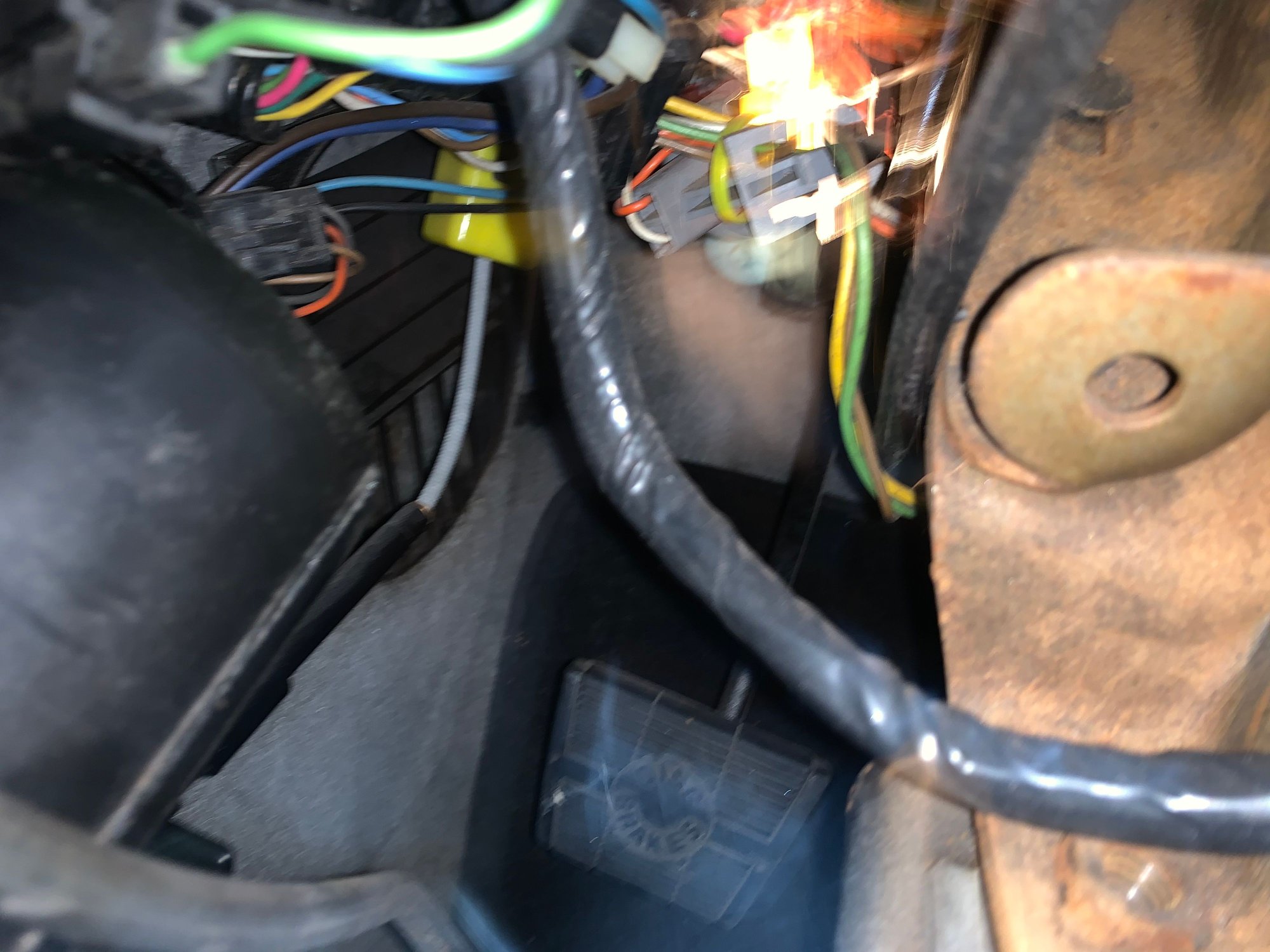

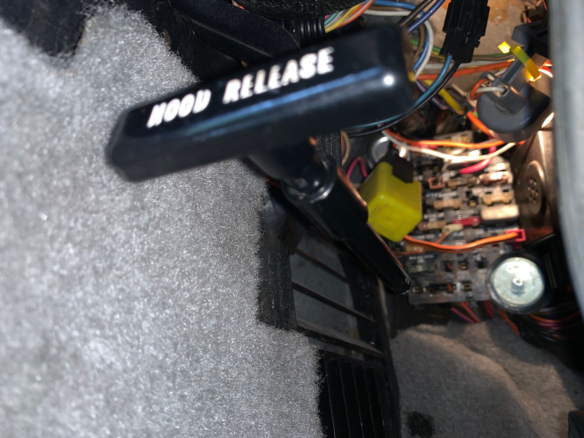

I just pulled my dash today and its night so I will send you a bunch in the morning.
Old Apr 5, 2020 | 02:45 PM
TO_Vette's Avatar
TO_Vette
Joined: Aug 2006
Posts: 307
From: Thousand Oaks Calif.
Default Hope this helps.

Thanks it doesnt show where the cable goes at the top of the fuse box but Ill figure it out.

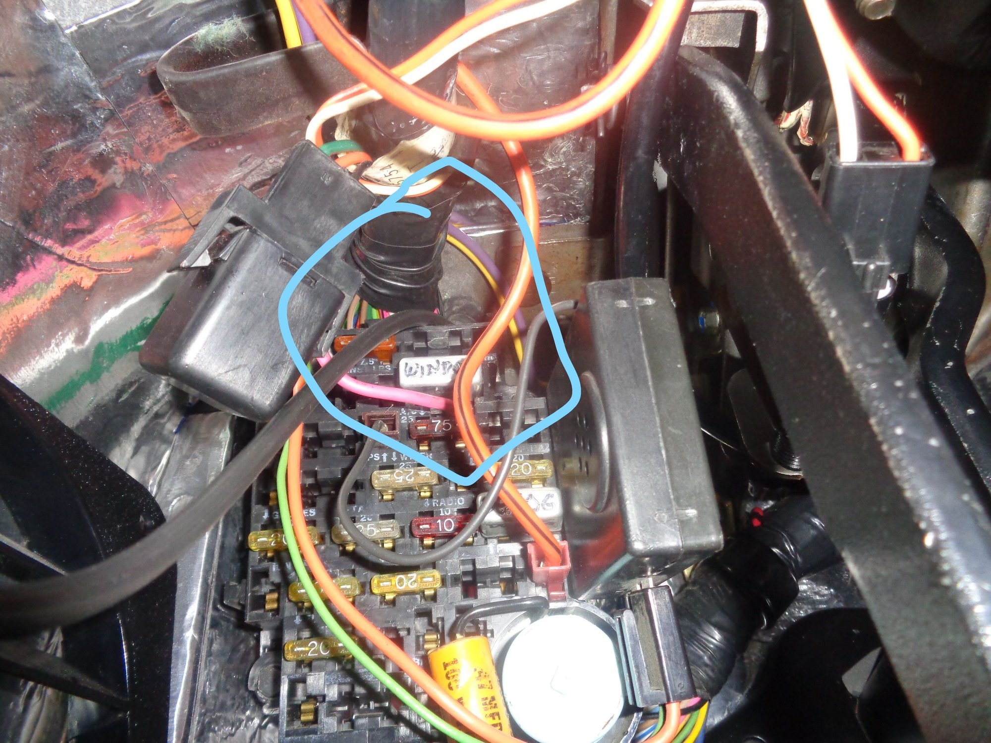

These pics help? The first time I did it, I removed the 2 bolts that hold the fuse box to the firewall, then pulled it away. It was still a bitch, but a little easier. This is my 79'
Old Apr 5, 2020 | 08:36 PM
Dan _R's Avatar
Dan _R
Joined: Sep 2018
Posts: 29
Likes: 7
From: So Cal
thanks duke94 now I see where it goes. May go after it if I take the seat out someday. I am normal size but cant really get both hands in there to work. I took the latches out and put some soft plastic in to support the hood so will go like that for awhile
