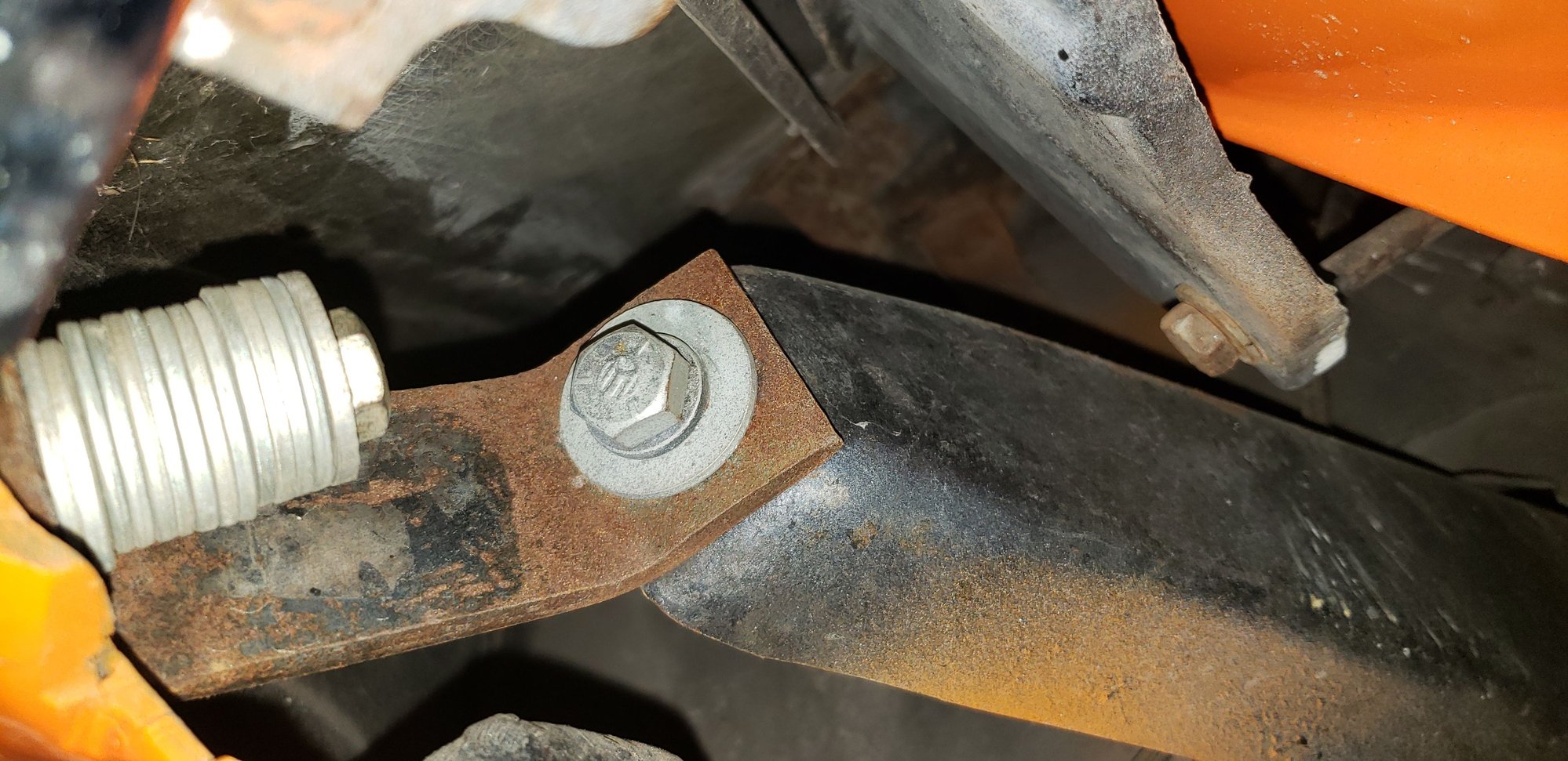

Found an interesting washer stack on the front bumper support.

Good get, I wonder if they still work...……….tm
