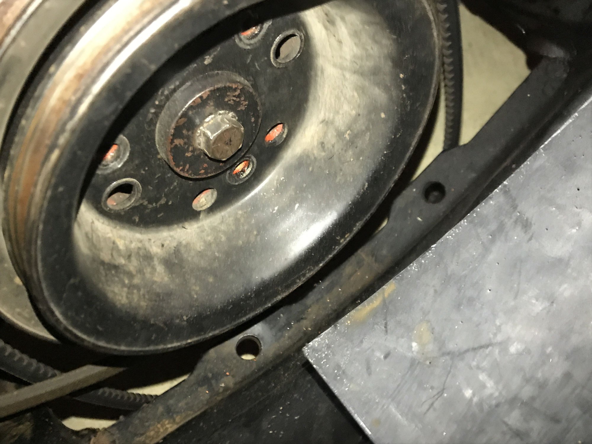

Old Jan 12, 2019 | 12:46 PM
Phillyboybolton's Avatar
Phillyboybolton
Joined: May 2018
Posts: 23
Default Same Spacer
I see the same spacer on mine. How did you break the bolt to pull the lower pulley? Impact wrench? I've attached a picture of mine.

Default Same Spacer
Photos
Here's the spacer on my lower pulley

Old Jan 12, 2019 | 02:37 PM
derekderek's Avatar
derekderek
Posts: 13,082
Likes: 3,399
From: SW Florida.
But to answer, yes that big fat washer on a center bolt is OEM. And it does stop you from taking the pulley off.

Old Jan 13, 2019 | 07:34 AM
Phillyboybolton
Joined: May 2018
Posts: 23
Thanks. Swapped out the balancer last night.
