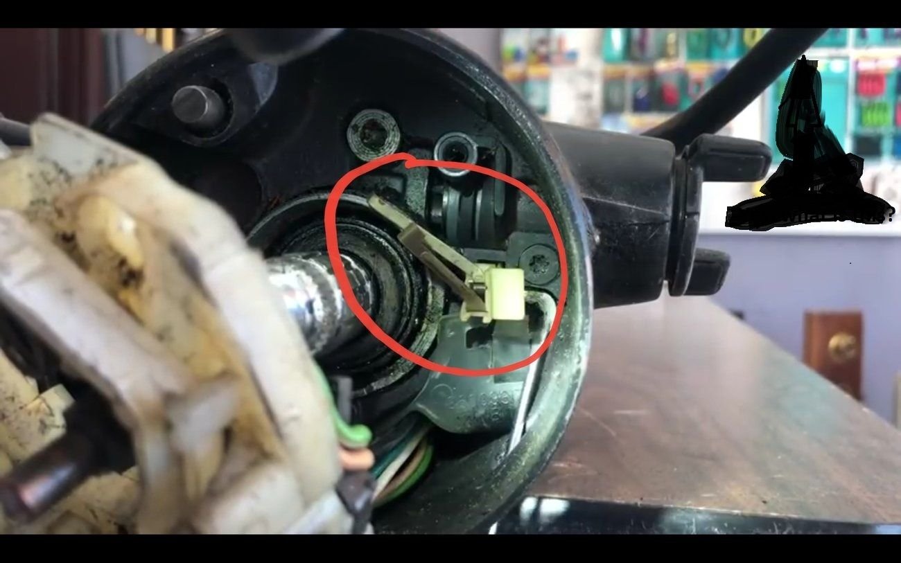

The part your looking for is in the column it slides down the ingntion can be fixed so you have to take the steering column apart down to the ingtntion switch take the. ing switch out then slide the switch out.the piece that has a spring on it

This is the part that makes the buzzer go off. When the key is inserted, parts of the key ground the metal and make the buzzer go off (other things are also involved, but it cannot go off without this part)
