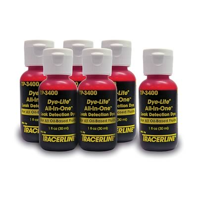

I had a similar problem last year & fixed by replacing the valve cover gasket with an upgraded gasket.
There's a "dye" you can put in the oil (and it won't hurt it) and after driving or running the engine, you can see where the leak is coming from. These are found at Summit Racing. Good Luck!

I have decided that that is the greatest stuff ever.
