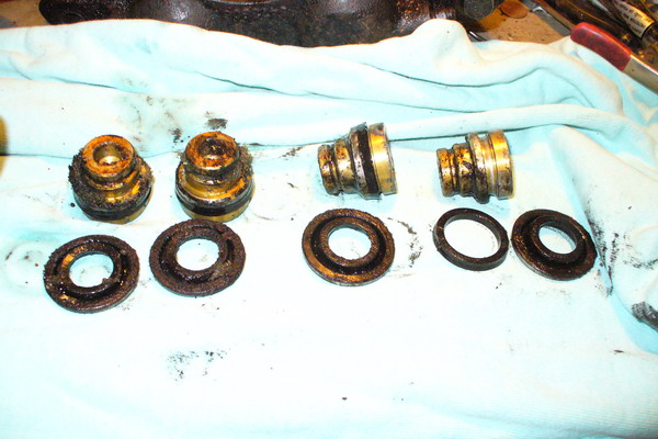

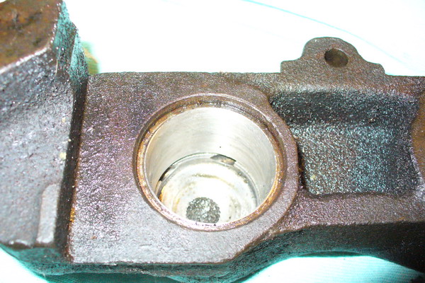

Hi Everybody
i just wanted to verify that these Calipers are sleeved.
i can't find any scratches on the sides but the pistons were filthy.
Also what kind of rebuild kit do i need?
and can you recomend someplace?
Thanks for your help.

Yes, those look sleeved. Your local parts dealer should have rebuild kits. You can toss everything out in the picture except the pistons which need to be cleaned up as do the cylinders of the calipers.

Yes look sleeved.
But make sure all your calipers were sleeved. I found only one sleeved caliper at my car. The other 3 were "old style".

Hi
Yes, sleeved, but toss all of the guts and get the O-ring conversion kit from VB&P for just over 100 USD including the pistons, seals & dust caps.
