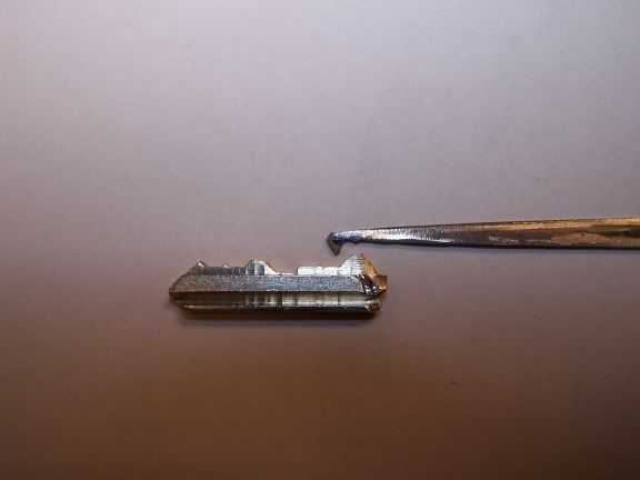

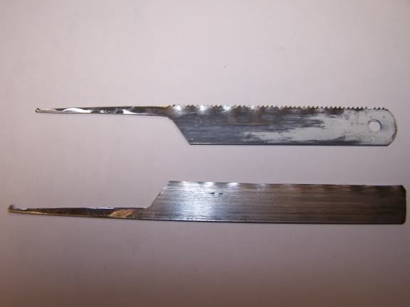

Here is a link to a paper that describes how to modify an old hacksaw blade to use as a pick to pull out the broken key bit so you can grasp it with a needle nose pliers.
http://jimshea.corvettefaq.com/wp-co...actionTool.pdf
Jim
