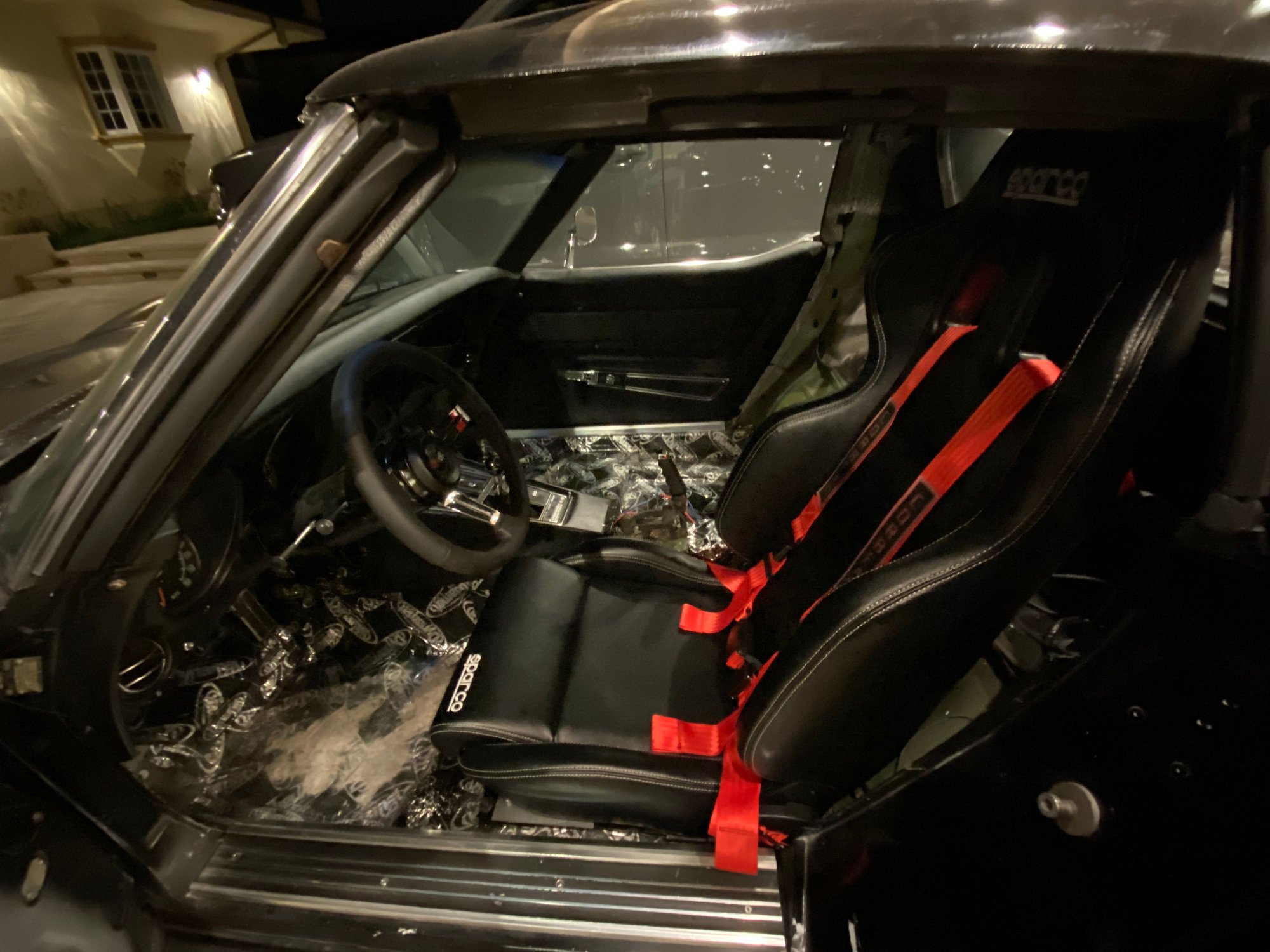

I have fit Sparco R100 seats in mine. Required a fair amount of work to modify seat tracks and fabricate a connecting bracket. I hope to do a full write up here soon.
Old Feb 11, 2020 | 03:23 PM
jonathand's Avatar
jonathand
Joined: Jul 2019
Posts: 103
Likes: 16
here's a photo
