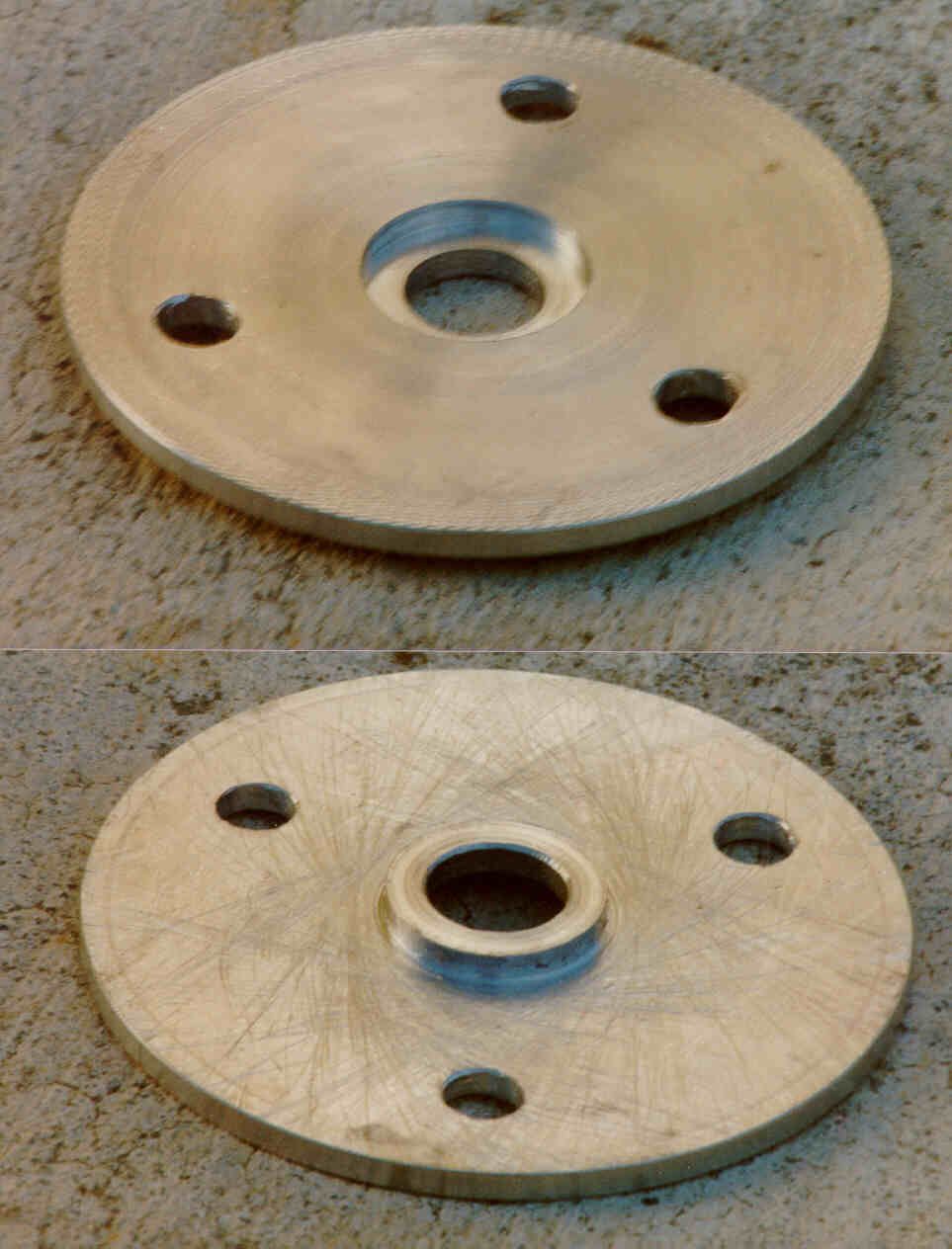

Some time in the early eighties (I think it was about then) GM made the short Corvette pump a little longer than the old short pump. When I put my engine together I used a GM aluminum short water pump, P/N 14011012; to get the belts to align using the original '69 pulleys I had to have this spacer made, it is about 3/16" thick.
Here's a shot of it:
My guess is you are trying to use an "old" pre-change short pump and need a "new post-change short pump. I hope this helps.
