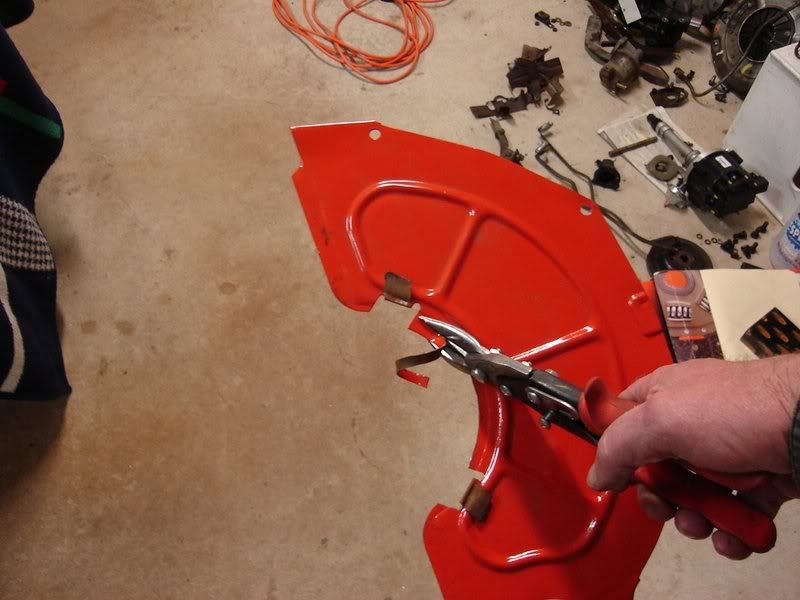

Having trouble bolting the bellhousing sheet metal cover on. Haven't solved that yet. Appears to be interference somewhere.
You have to trim the large opening that goes around the crankshaft with a good pair of tinsnips. Remove about 1/8 of an inch. I have a picture somewhere I'll post later.
Here's a pic. Note the position of the tabs that will clip against the rear main area of the oil pan. And I agree with Binnie77, you must have misspoken, you have to change the flywheel.

Thanks for the tip on trimming the cover.
