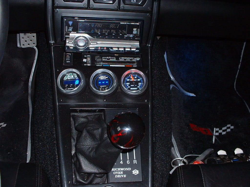

I have one mounted in my console and you can see the shift flash even in daylight with peripheral vision. I would prefer to have it mounted in a pillar gauge pod but it seems no one makes one.
http://www.autometer.com/cat_accesso...l.aspx?vid=199
