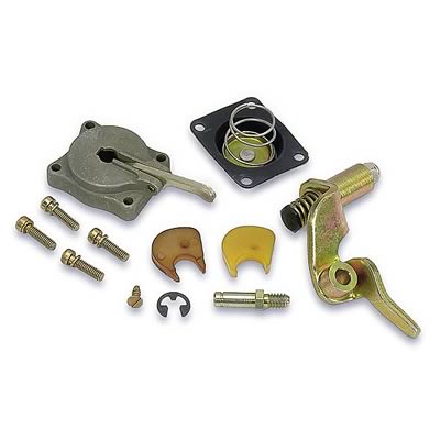

I also think that you have a 50cc accelerator pump. The pump lever shown by Barry's70LT1 is for the 30cc pump. I don't think you can find a smaller pump arm for this kind of pump.
This one is from the Holley kit :
And this one from MOROSO, for Holley carbs, very similar :
I think you'll have to punch a hole in your air cleaner base, and remember that this lever moves !
