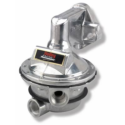

I ran this Holley with my current motor and never had a problem. 12=327-11
