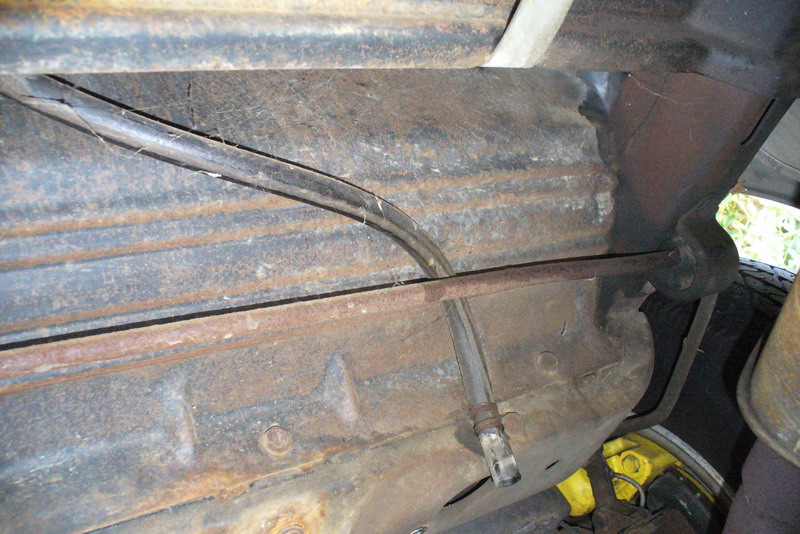

I drive my '75 every weekend, and I think i have a fuel leak for 2 reasons.
1. everytime i start the car for the first time, i have to wait a lot for the fuel to get to the carb.
I have a fuel pressure gauge and after a week, there is no pressure what-so-ever in the system.
I hadn't thought much about it until,
2. about 2 weeks ago, i was at a car show and got rained on, and after driving home about 2 miles, there was a slight gas smell around the back of the car.(I did fill up before the show)
the next day, the gas smell was really bad by the back of the car, and there was an area that looked like evaporated liqued underneth the pass side rear.
Before this, i haven't smelled any gas or seen any traces.
(I'll also admit, that since it was raining, I had slight traction problems. :thumbsup3
so I removed the spare tire carrier to see what was there.
i found a drain tube which i assume was to drain from on top of the tank, and it did have a drop hanging from it.

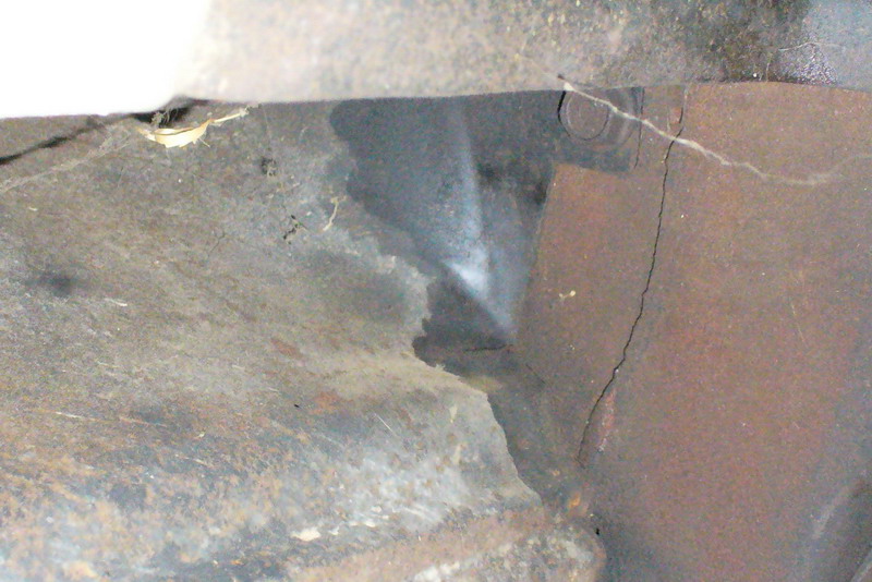

But i also found this wet area up in the right corner, i scratched and sniffed and it was deffinatly gas too.
At this point I'm not sure where to go, it looks like the metal panel right behind the hose comes off, but i'm just not sure.
I figure there's a cracked hose somewhere back there that needs replacing.
My questions are
Where could the leak be at?
and how can I get to it?

I think the drain hose you show is for the seal around the gas cap area to get the water out of there. If you do drop your tank, you might want to have someone look at that frame rail. From the picture you posted it looks like it has a pretty good crack in it.

I believe that's a seam not a crack.
Yes, seam.

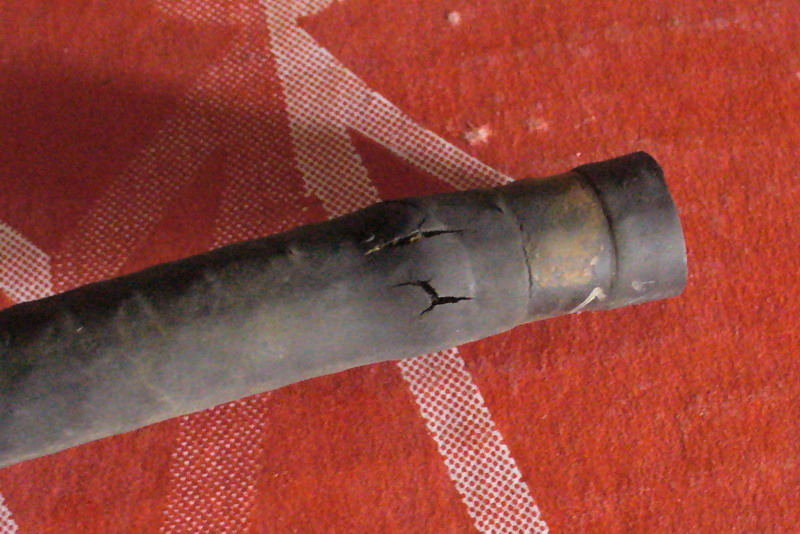

So I finally dropped my gas tank and here's what I found.
you were right, thanks for your help.
and there'll be a gas tank hose replacement thread coming soon.
