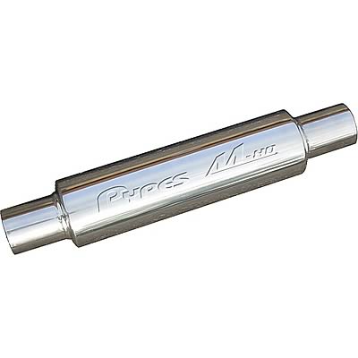

Is there any room under the car for a couple more small mufflers?
Something like these might work.
http://www.summitracing.com/parts/PYE-MVR200S/
