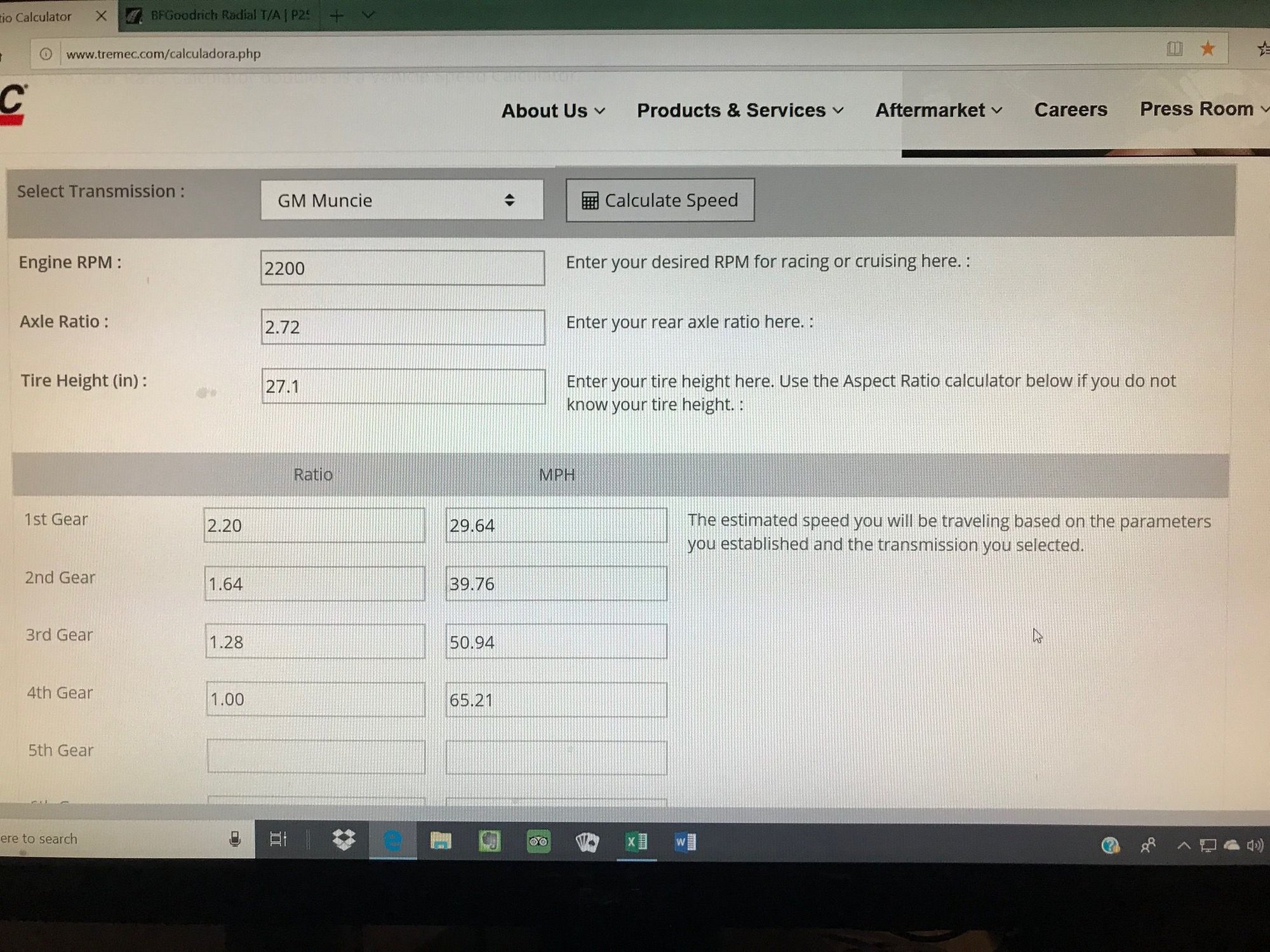

This morning, before finding this great old post, I took a ride to determine my axle ratio, logging RPM at various speeds from 50 to 75. I have a 4 speed 81 and the math confirms the 2.72 axle ratio...
