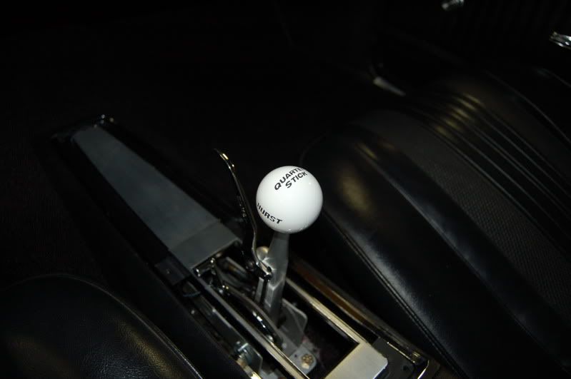

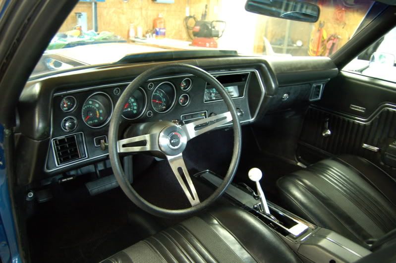

What auto shifters are you running and why do you like it? Post any pics or videos if you have any.
My brother is wanting to upgrade the factory shifter in his '79. It's just too easy to overshift. I'm trying to talk him into Hurst's Quarterstick, because I'm sure it would work in his console. I retro-fitted one into my console and love this thing! It's impossible to overshift and it doesn't have ratchet action.

Looks like my old 72 SS454 Chevelle minus the steering wheel. How do you miss a gear with an auto ?

I bet you wish you still had that one! This is a '70. It was really easy to shift from 1st to 3rd or from 2nd to neutral with the factory shifter.

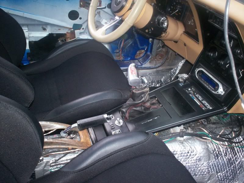

I've got the Quarterstick too, but it's a pistol grip! All I need to do is fab a cover or a leather boot for the bottom portion of the shifter.

That looks great Paco. How are you going to make a leather boot?

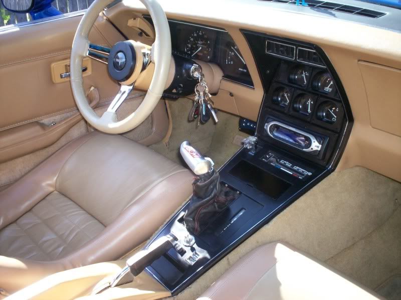

What year is your Vette and what shifter is that? The install is plenty clean by my standards, so what mods did it take to get it to fit? Are you happy with the shifting? I've been wanting to upgrade my TH400 shifter for many years now to prevent missed shifts in manual mode. Thanks.

Thank you Les. My 76 has the Hurst Pistol Grip. I had to deform the floor pan and open the gate up to get it to fit. I also modified the rev. lock out lever and the shift lock lever & buy a longer or shorter cable... I don't recall why. I'm happy with the shifter and was glad to get rid of the push button/ball factory shifter. It'll take ya half a day to put it in.
