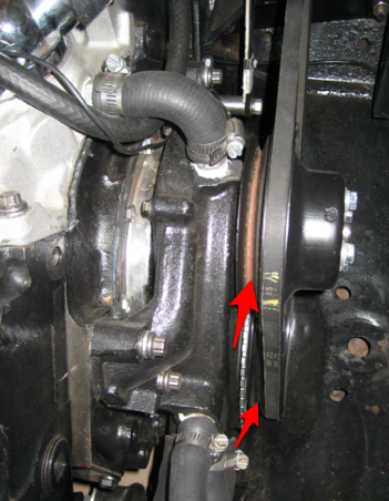

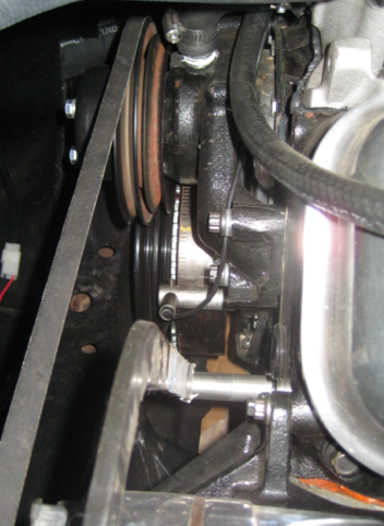

Hey guys, quick question: I want to add a PS pump to my BBC for the addition of a steeroids and hydroboost but I'm not familiar with what pump or bracket I need. Can anyone ID this for me from the pictures?

OK seriously. How does one go about figuring out the right configuration for their particular engine/setup?
I have racked my brain and browsed Zips/Summit/Jegs for 3 days trying to figure out how to order everything in 1 shot and get it right the first time.
At this point I'd spend $2k on a March serpentine setup as long as I knew it would be correct.

In my test fit with the stock style bracket kit, the alternator pulley inteferes with the upper radiator hose! Is this common? Is there another hose with a sharper bend, or is something else setup wrong?
You need to turn the radiator hose so that the bend is nearly laying against the radiator. Mine was more straight up and down and was almost hitting the alternator pulley.
cc
This isn't a very good picture but I think you can see the hose bend laying close to the radiator.
