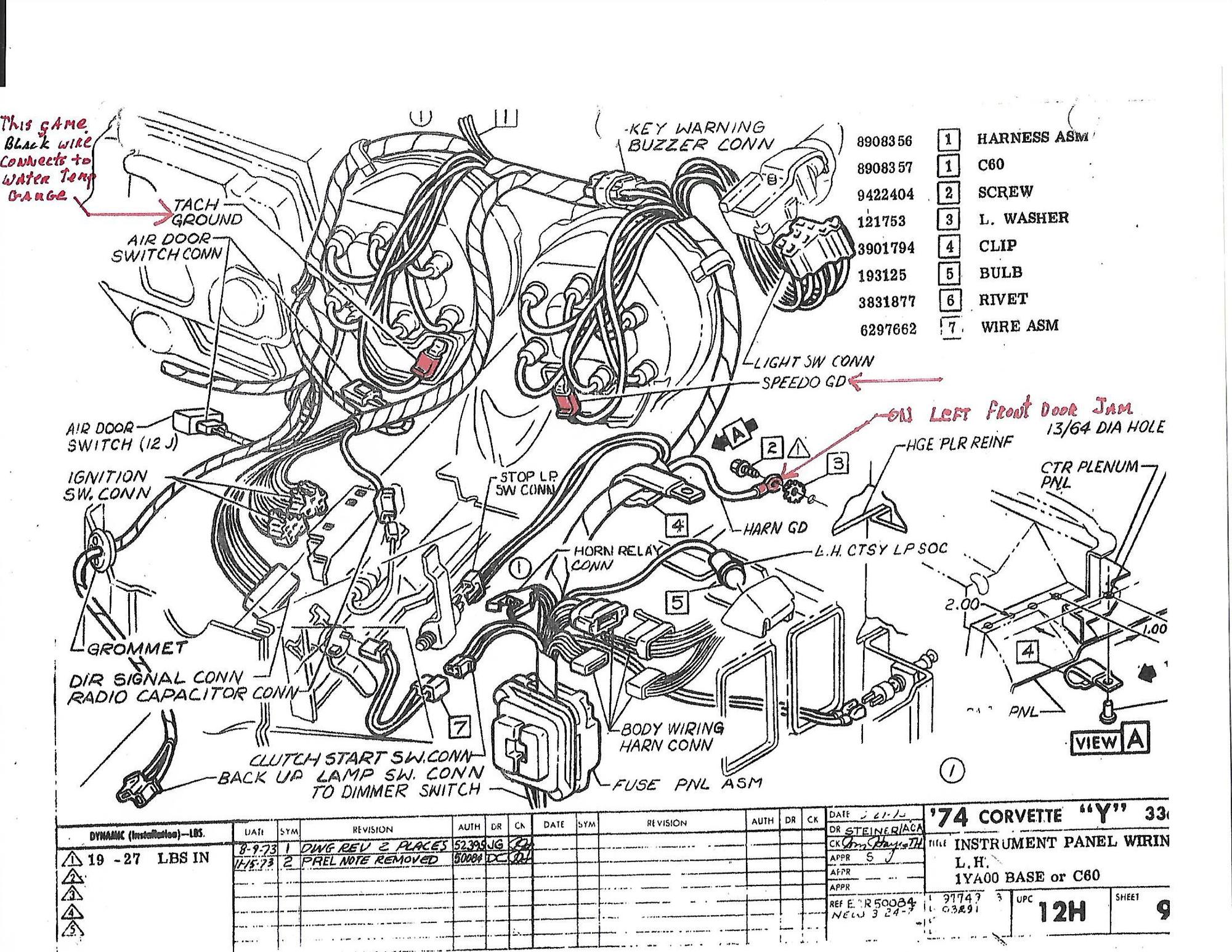

For the dash lights to work they need a ground.
A Black wire goes from the water temp gauge to the tach and speedo and is attached to the 'A' pillar just above the bottom of the left side dash.
Pulling the light switch to the first or second click sends power the the 'tail light' fuse and the 'tail light' fuse sends power to the 'instrument' fuse. Test that both fuses are good by probing the 'Clips' that hold the fuse on both the left and right side.
