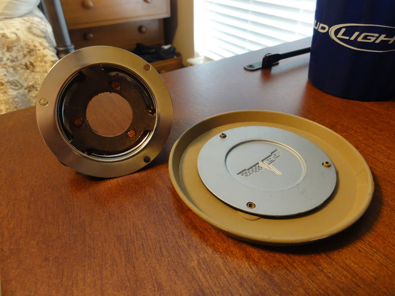

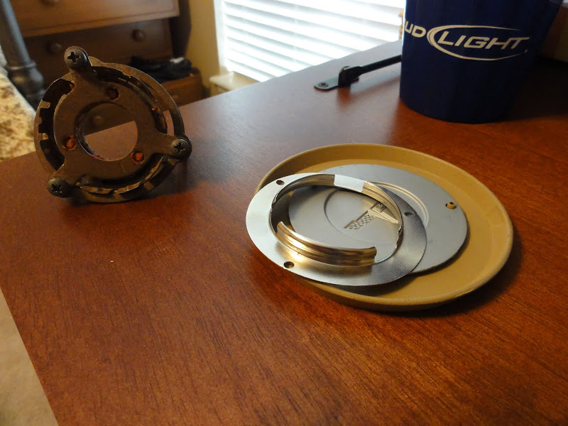

I can get all the horn parts together and working, up to the silver piece that snaps in. It is my understanding this piece attaches to the horn button some how, and that is what keeps it in place. I can not for the life of me figure out how to get it to attach. Maybe I am missing a piece, but according to the exploded views I am not. It is a 1977. Below is a photo of what I have. The first photo is how far I can get, horn works. The second photo is the what I can not get put together so it will attach to the column. Also the exploded view I am going off of. I found it doing a forum search.

The three tabs have to be spread out , to hold it all together. Use a center punch or drift, that will stretch out the tabs to hold them tight.

Awww, gotcha. That makes sense. Thanks.
