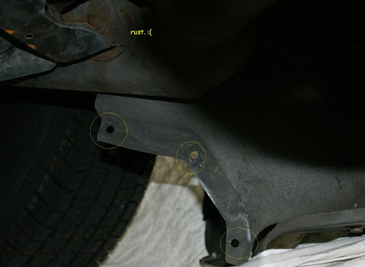

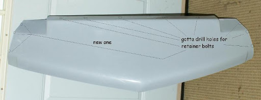

EDIT: Did a fit test with the air dam I bought from ecklers. The left and right side of it doesn't have enough fiberglass surface area to put on the 3 retaining bolts. It has room to put TWO (the middle and bottom holes), but not the one on the top. I am not happy with their press molded air dam at all now.

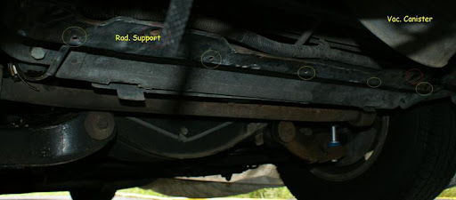

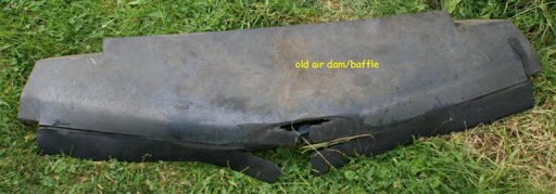

Took some pictures.
Old Air Baffle:
New Air Baffle:
Remove/attach air baffle to radiator support. The AIM depicts 2 retaining bolts (circled red) or you could attach using 5 bolts (holes circled yellow). The 5 holes might be specific to my car only though.
LH side where 3 retaining bolts attach the left side of the spoiler. Same for RH side.
