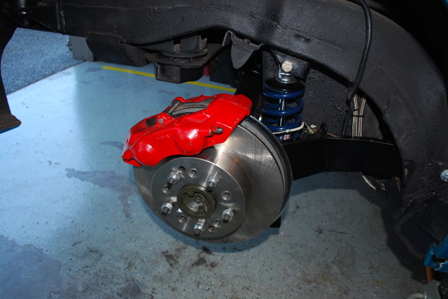

I have completed this install, but do not have the car on the road yet. Here are a few pics. I used the complete kit, the one that includes the new offset trailing arms. One issue that needs to be addressed is the brake lines, plan on either making or have made the hard line to the caliper.
Reason not on road yet...
