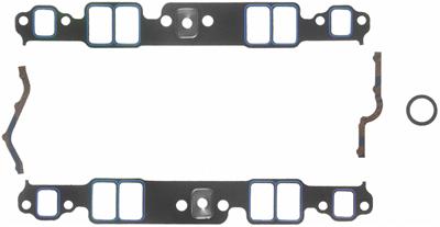

Here is a picture of the gasket that came out of it. These fit no problem with those valve covers. So I need a set of these whatever they are.
[IMG][/IMG]

Just ordered these http://www.summitracing.com/parts/FPP-1604/

They look like the Felpro gasket you'll get when you go to NAPA. (If you look very closely, you should see: "This Side Up" on on side of the gasket. Did yours not have the metal restrictor in the center cutout?
